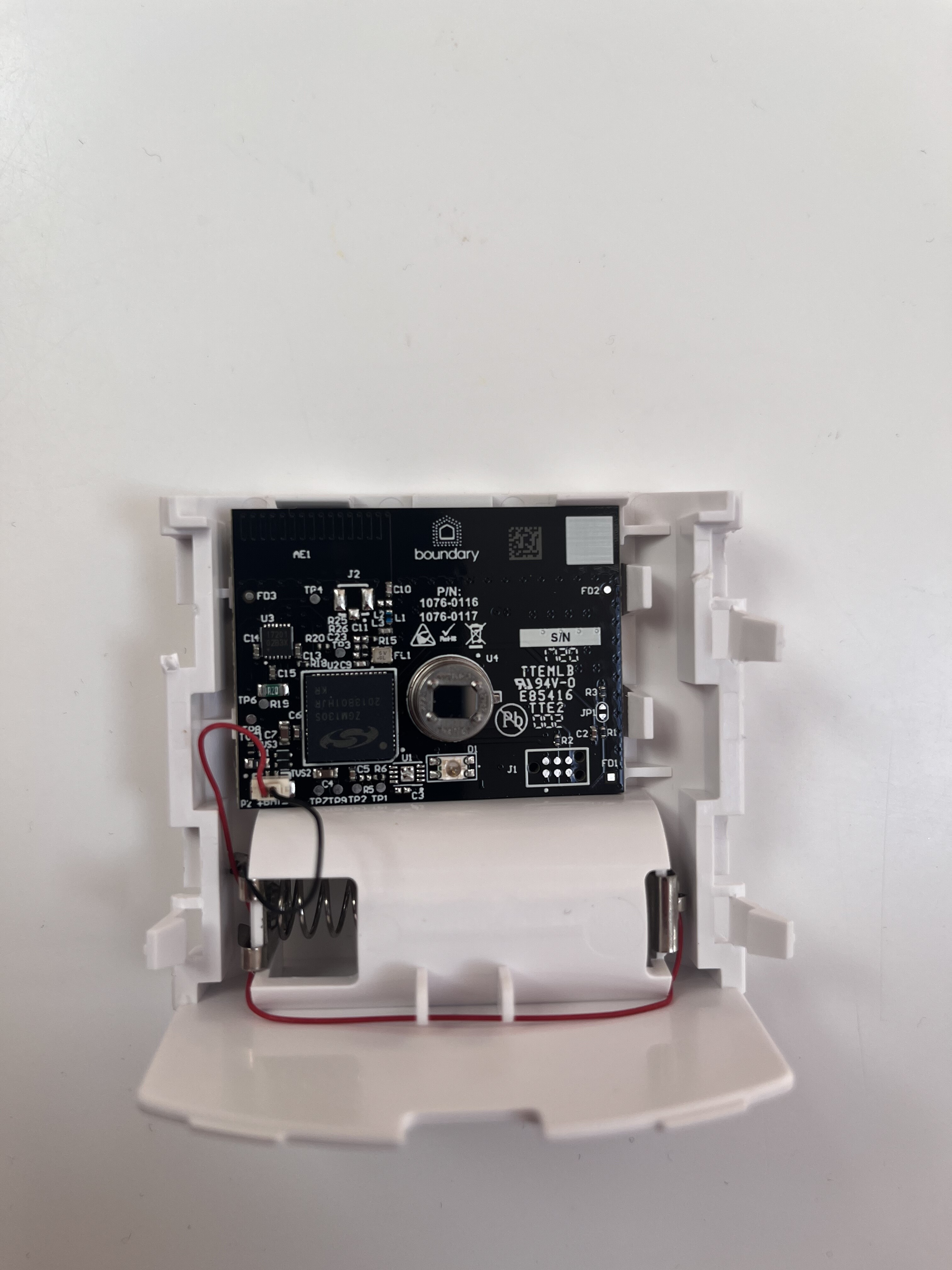

As for the sensor itself, there are no markings on it as they’ve made their own cases so would need to try to open it up to see what’s inside… as you say, I very much doubt they’ve built their own sensors from scratch.
…it’s doing something though. The sensor sent a temperature reading an hour ago which sounds about right. I’d have thought if it really was encrypted you’d not get anything comprehensible coming from the sensor without the encryption key to decrypt it.
Maybe I should try to bust open one of the sensors to see what’s inside… I don’t have anything to lose!
The sensor is close to the SmartThings v2 hub so I don’t think range is an issue… and have plenty of other powered Z wave devices around the house it could route through if needed.
Hmmm… it does appear to be custom hardware, even if they have used someone else’s chip. Doesn’t sound promising!
