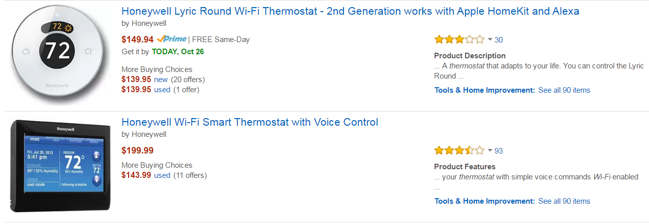

I would recommend to use a wifi thermostate as they seem to suffer less disconnects as I heard about z-wave thermostats. I use a Honeywell wi-fi thermostat and only really had problems 2 or 3 times over 2 years installed. It is a cloud to cloud integration with SmartThings, but it works out great. And the community will help you on the integration too, Anyway…Checkout this list:

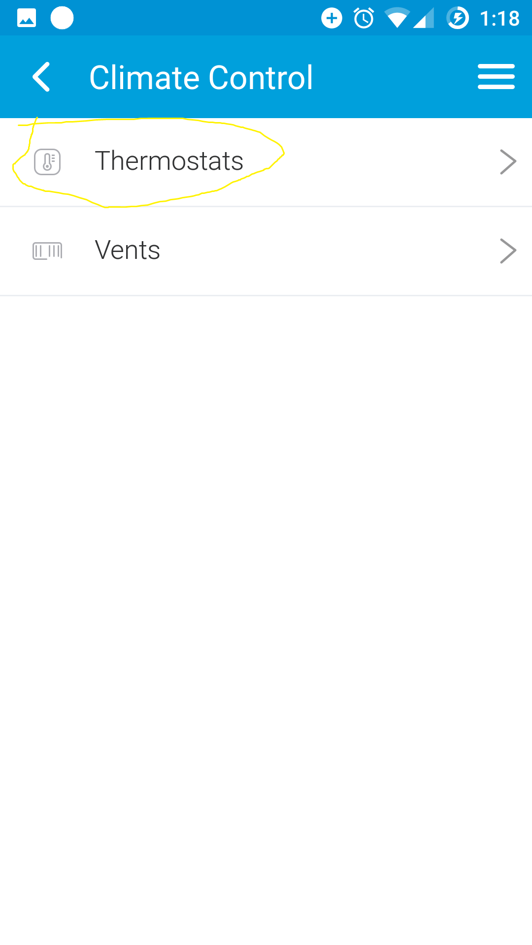

You got it. So, you install the thermostat (Need a ‘C’ wire to your central unit for power)-> connect it to your wifi -> download the Total Comfort app from IOS/Android -> than you can follow the pictorial for the supported thermostats below:
I have the RTH8580WF model which is on the Amazon screenshot, but is not officially integrated… To integrate this model, you need a community created device handler which you can find. But it works out too.

When you setup SmartThing app and account. Go to this address to add the above code in the My Device Handler tab.
https://graph.api.smartthings.com/
