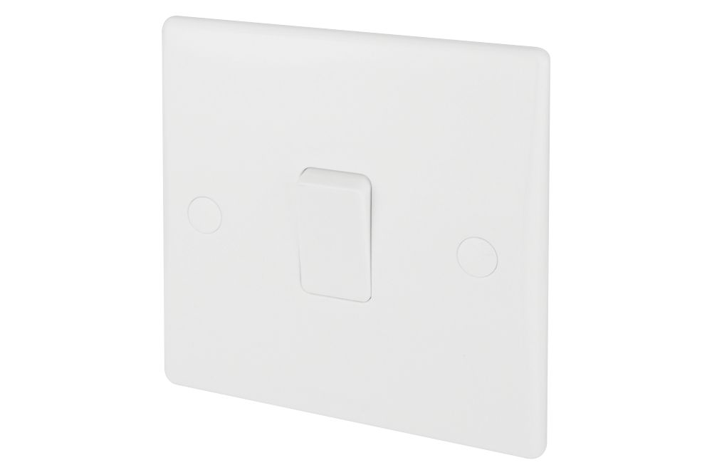

What country are you in? There are some nice inexpensive retractive switches that work well with the in wall relays, but the frame shape is different depending on whether they are intended for the US or the UK.
Not sure exactly of the drawbacks you mention. I recently implemented an Enerwave z-wave plus ZWN-RSM1 relay for a group of Hallway lights that were 3-way with conventional wiring for 3 switches. My home is around 13 years old so I had neutrals in the boxes and power accessible so it was easy to install 1 relay at the right switch & it works great. There is a very minuscule delay when turning on or off but most don’t notice and best part was that it changed nothing in the standard controls. Pretty much seamless utilizing existing switches. Unfortunately I know not everyone has had as easy an experience as my own, but if you know your wiring, I don’t think it’s difficult. I am planning to get a few more for other areas of the house.
If you’re in the UK, I would definitely look at screwfix, they have a whole bunch of retractive switches, including Schneider, for less than £4 each. Or you can spend more and get a more elegant style.
If you’re in the US, you can definitely get an inexpensive plastic momentary switch for under $10 each. You’ll commonly find these listed as appliance switches or maybe for garbage Disposals.
If you want something mid range, Cooper makes a very nice momentary switch that looks very similar to a regular rocker and usually cost just under $15. Shop around because price varies a lot on these. (Eaton is the company, Cooper is the division, The switch may be listed under either name but with the same model number.)
There are many other choices as well in both countries. Just look for a “retractive” or “momentary” switch. These are switches like a traditional doorbell button, they rest in a neutral position. When you press it, it toggles on or off and then returns to the neutral position.
