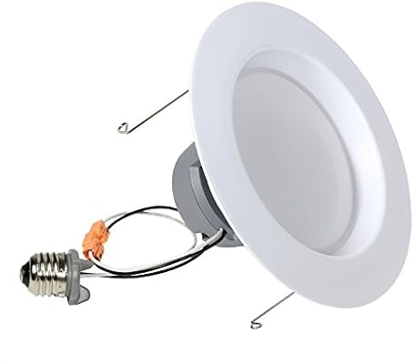

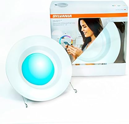

If you want to use a retrofit can replacement, the Sylvania lightify RGBW can lights can be connected directly to your smartthings hub. The kit is a complete kit, it has the bullb built into it.
These are about $10 less per bulb than the Phillips hue. However, you don’t get quite the same functionality that you do with the Hue. In particular, I’m not sure where you can change colors with Alexa with these or not.
Linear/GoControl also makes a retrofit light kit which is Z wave and can be connected directly to your smartthings hub. Again, the bulb is built into this. It is about $10 less expensive than the Sylvania, but it only has white, not colored light.

The first thing you need to do though before purchasing anything is to see exactly what your current recessed lighting consists of. The BR30 bulbs are I think 3 3/4 inches across the entire bulb. So if you measure the width of the current bulbs in your ceiling now, and they are that size, then you can simply purchase any of the BR30 bulbs that are available and fit your budget and specifications.
If when you measure the existing bulbs and they are smaller than 3 3/4, then there are other bulbs (GU10 and PAR16). If your current recessed lights consist of a larger diameter and maybe with a lens covering the outside, you can typically slide that down from the ceiling and look inside to see what bulb is in there. Yen there are the options of the retrofit kits as well.
