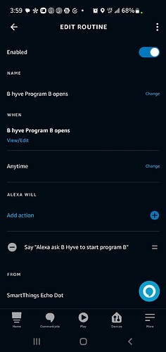

That is the tricky part. Alexa needs to say it
For example
I have some other devices that have Alexa Skill, but only way to control them is by voice. However this workaround works with virtual deveces. Another example
I use custom actions to simulate spoken voice commands.
Thanks for the reply! I have everything setup as you describe. When the virtual device turns on, I can hear Alexa say “Alexa, call moi”. But nothing happens after that, no call is made.
No idea if this works but you could try using a custom trigger instead of the Alexa trigger.
This worked, thanks!
