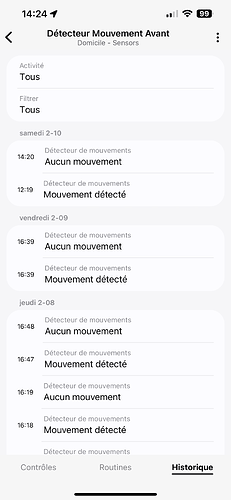

Same problem returned since Saturday with my 2 Hue outdoor motion sensors.

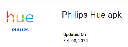

This time the problem is weirder, ST sometimes detects movement and sometimes not. Everything worked flawlessly until this Friday, the update to version Hue 5.10 started to be distributed on Thursday, so I suspect there is some connection there. Can anyone with a previous version verify that the issue is caused by the latest update?
SnĂ­mek obrazovky 2024-02-12 200912
My iOS Hue apk (5.10) was updated Saturday. No issue with Alexa or Apple Homekit. Sometimes it detects in smartthings but the majority of time, no detections. I don’t know if the hub was updated last week.
