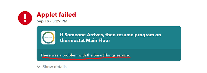

Had a some minor IFTTT trigger issues yesterday. But seems to be working better now.

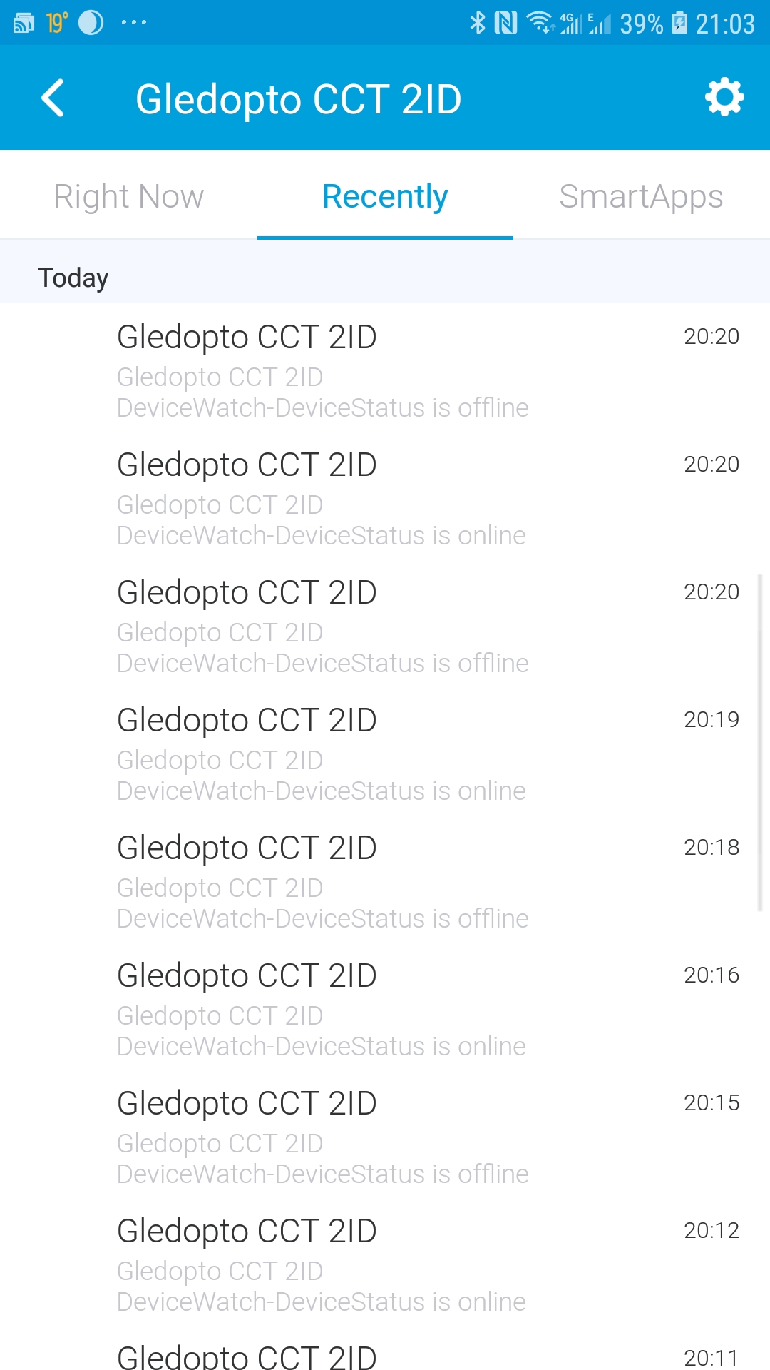

I have problems with the Zigbee lights (Gledopto and Hue).
Continuesly online, offline, online

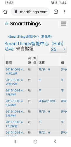

Hello, everyone. I am from China. I have a hub V3 and a connect home. Three days ago, my connect home and hub V3 began to crumble and broke off in half an hour. Today, after I deleted some ZigBee devices, it seemed good. I don’t know what’s going on here. My firmware is 27.9。
