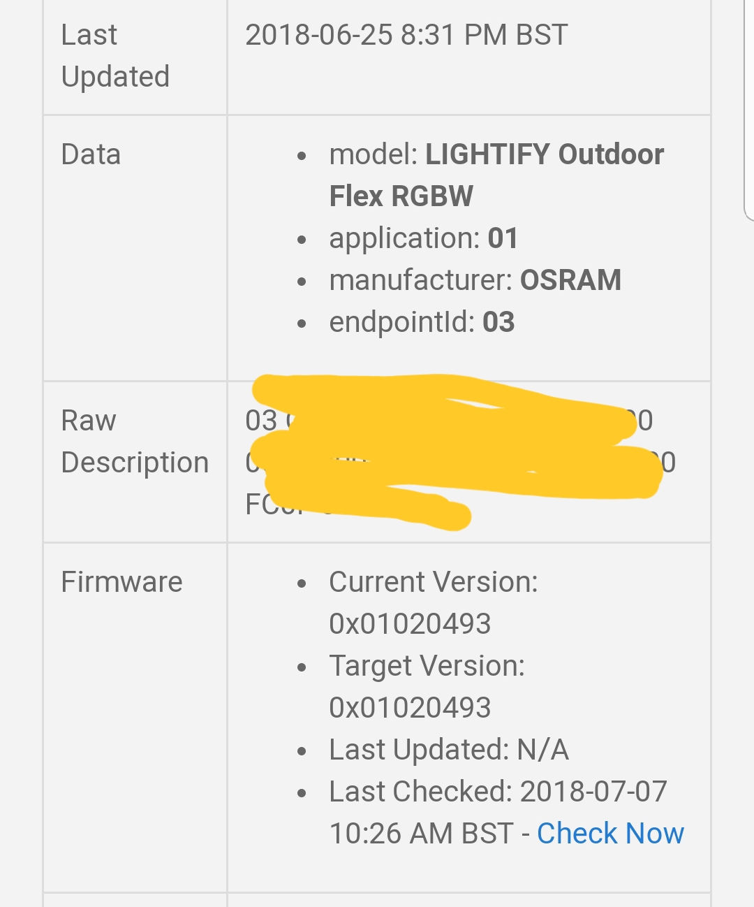

Re. this, should I assume that my Osram Smart+ Outdoor Flex is already on the latest firmware?!
Yes. I believe only UK OSRAM (which are ZigBee Light Link (ZLL) and the newer US LEDADVANCE/SYLVANIA versions are included in this firmware release.
Thanks @jhamstwad. For clarity, I am in the UK and was wondering if my outdoor flex should’ve received an update as the FW version hasn’t changed and the update is saying N/A?
Reason I ask is because if this is on a ‘good’ Osram firmware out of the box, then I won’t need to invest in a Lightify Gateway to update it (for some reason UK users can’t update OTA like the US, even if you’ve got this setup) to avoid the numerous known issue Osram has with ST.
  • OSRAM - various bug fixes (UK ZLL models)
    • Garden RGB - FW 01020412
    • CLA 60 TW - FW 01020412
    • FLEX RGBW - FW 01020412
Your version is higher than the ones listed in the update. I don’t know what the most current firmware versions is, so I couldn’t say if getting the gateway would benefit you in any way.
