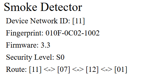

It’s possible to copy HTML (route etc) using AWA my.smartthings.com/advanced. Paste HTML to HTML file. I’m using Notepad++.
Open HTML file using browser.
Using AWA is possible to find Z-Wave devices’ Network IDs

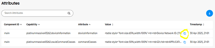

Where in the AWA are you finding the routing?

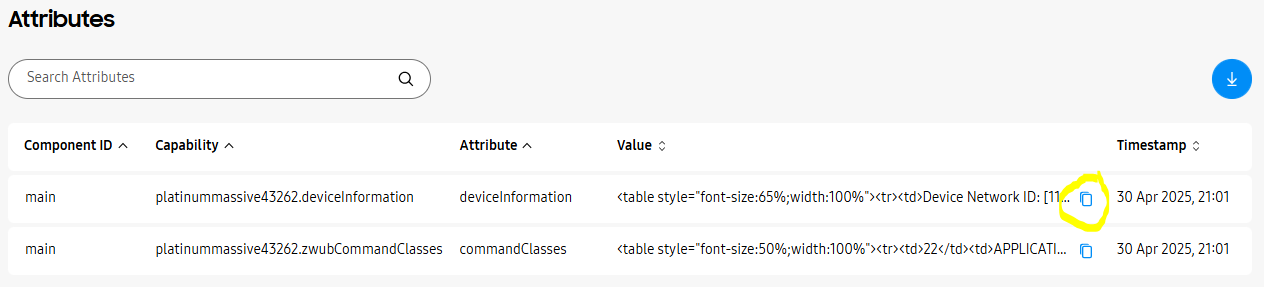

When device is using Z-Wave Explorer driver you can find routing etc info here
Pressing the highlighted item copies the HTML (route, etc.) to the clipboard.
