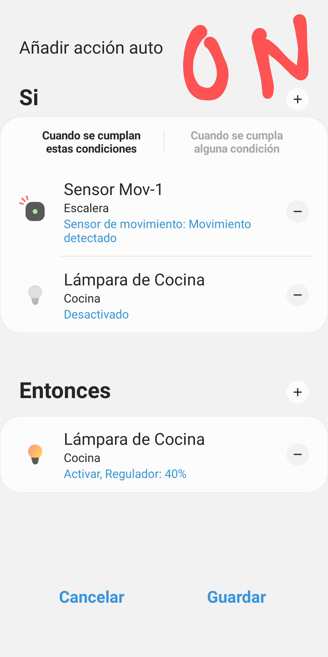

You can add in the IF part of the automation when motion is detected AND the light (dimmer) is off.
So when it is ON, the automation will not be activated

Hi Tom,
Sorry, I will try to express myself as clearly as I can, English is not my language
2nd Automation:
“IF” movement is not detected for X time “AND” the light is “on” at 40% level.
“THEN” Turn off light
This second routine will only turn off the light when it detects no movement for X time and the light is “on” and 40% level, that is, as it was turned “on” with automation 1.
If you manually modify the level, it will not turn it off until you manually turn switch off or manually restore level to 40% and it stops detecting motion for X time.
