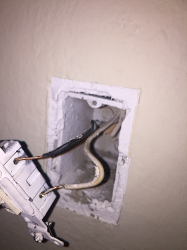

I need help I just get a new smart wall switch and what a surprise when I try to install it and discover there is only one last me in my wall!!! Just one cable coming in and out that’s it how can I install it with out any other cable??? There is a way or not!
That means you are missing a neutral wire. It’s usually at the light fixture box. You have 3 options.
  1. You can install an on/off relay module at the light fixture box. Aeon, Emerwave and a few other brands.
  2. You can install a dimmer module behind the dumb switch. Aeon nano or fabiro
  3. Lutron Caseta dimmer switch but you will need the lutron bridge.
