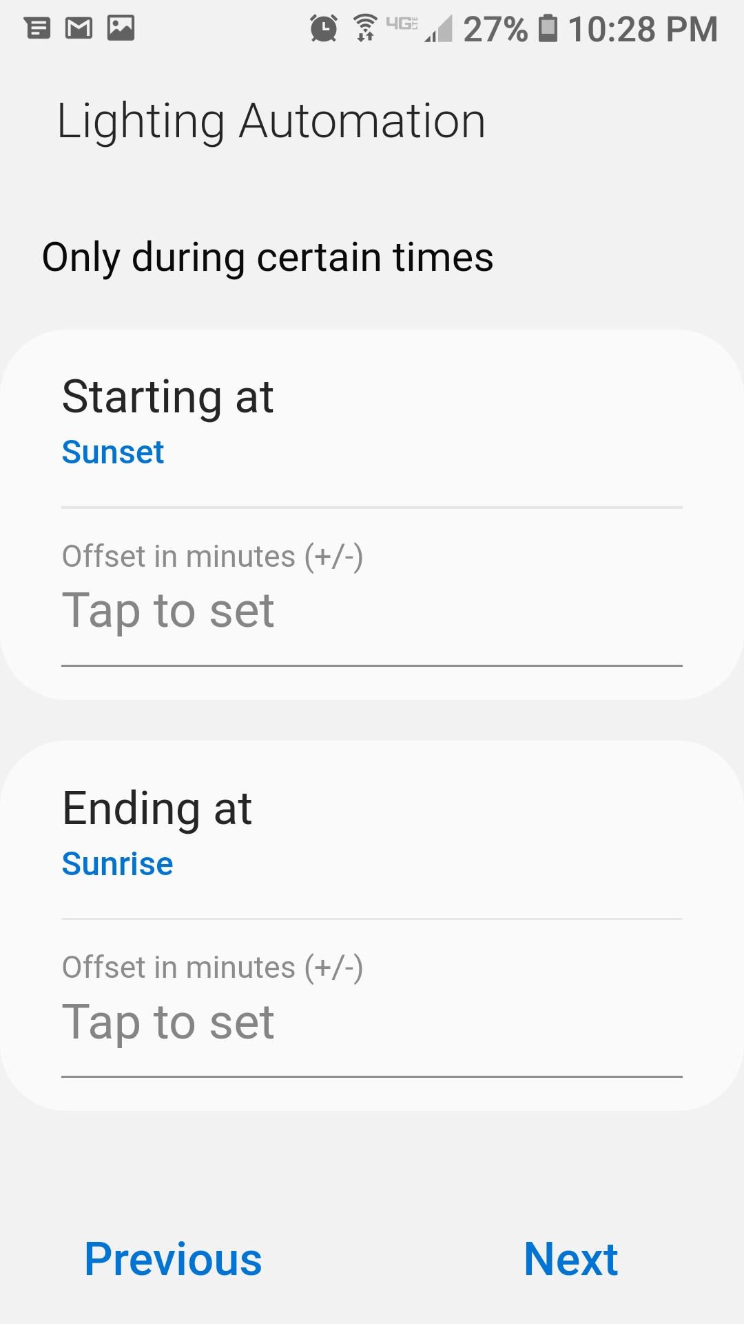

To be clear, I want to light to come on when I arrive at night.
OK. I found the smart lighting automation. I can trigger it on arrival but how to I not trigger it during daytime?
I can’t remember the official description but it’s a built in smart app that allows you make automation rules. In some instances these rules can run locally. It’s located within the automations section. See the screenshot. You will be able to turn your light on the way you want using smart lighting.
I found it. Thanks and the “more options” gives me the time control.
I’m all set
