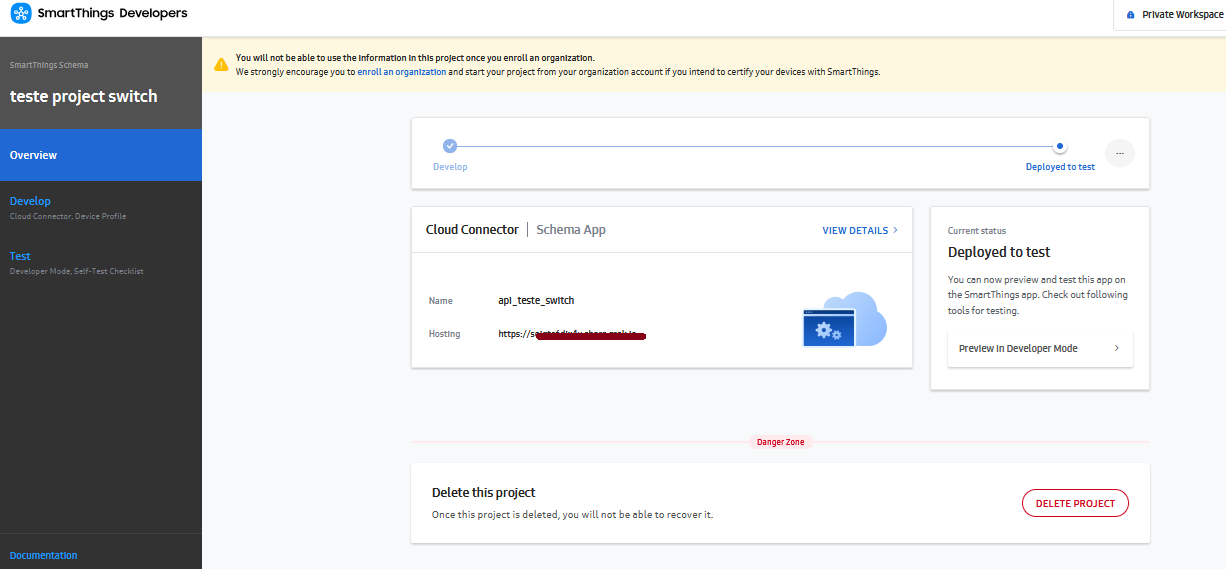

So my question is, now that i have my own smart app ( Oauth server integrated with my smarthings profile), how should my http requests look like ? Am i supposed to use the same API URL as when using PAT? Where do I get the refresh token from to insert on the http requests ?
Thank you so much,
As you can see on the pictures attached, i have the could connector , device profile, and the schema app all set up. But i got stuck how to make the requests to get the Smartthings devices infos.
I’m really sorry for the confusion. The one in the video is a different OAuth server intended for Cloud-to-Cloud device integration.
The one I meant was this one: OAuth Integrations | Developer Documentation | SmartThings. This one is to access a user’s location depending on the scopes he/she authorizes. (For example, list devices, send command to devices, etc.)
