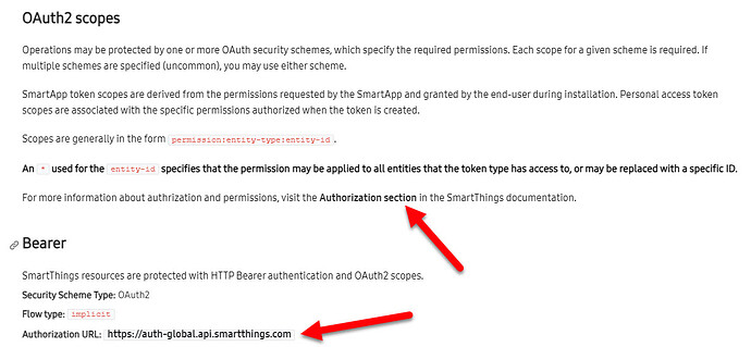

The relevant links in the documentation (“For more information about authorization and permissions, visit the Authorization section in the SmartThings documentation.”) no longer work, nor does the URL (https://auth-global.api.smartthings.com/).

It would be useful for us if you could share with us which links in the developer portal you’ve found that no longer work, please. I saw one link referring to “Authorization and permissions” and it works correctly sending us to https://developer.smartthings.com/docs/getting-started/authorization-and-permissions.
What @orangebucket mentioned above is correct, the URL of https://auth-global.api.smartthings.com/ used to be for SmartApps in Groovy, right? In that case, SmartApps where a different concept.

The dead link and wrong endpoint are right at the beginning of the dev documentation:
API | Developer Documentation | SmartThings.
I now try to figure out token lifetime, refreshing a token, etc. but cannot find the documentation about it.
Thanks for the info @Bluebrain, I created a ticket about that
About this URL, it seems I was wrong and it’s still live, I’ll check more details about it.
