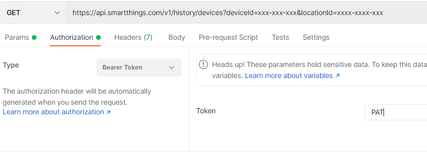

Now I want to know how to query the history events on each device and sensor by a http request.
Thanks a lot!
Now I want to know how to query the history events on each device and sensor by a http request.I have created Personal Access Token,how to use it?
Please help me.
The events history is in a different endpoint, you just need the deviceId
, locationId
and use your PAT in authorization, here’s an example using Postman:
Thank you very much!It solved!
