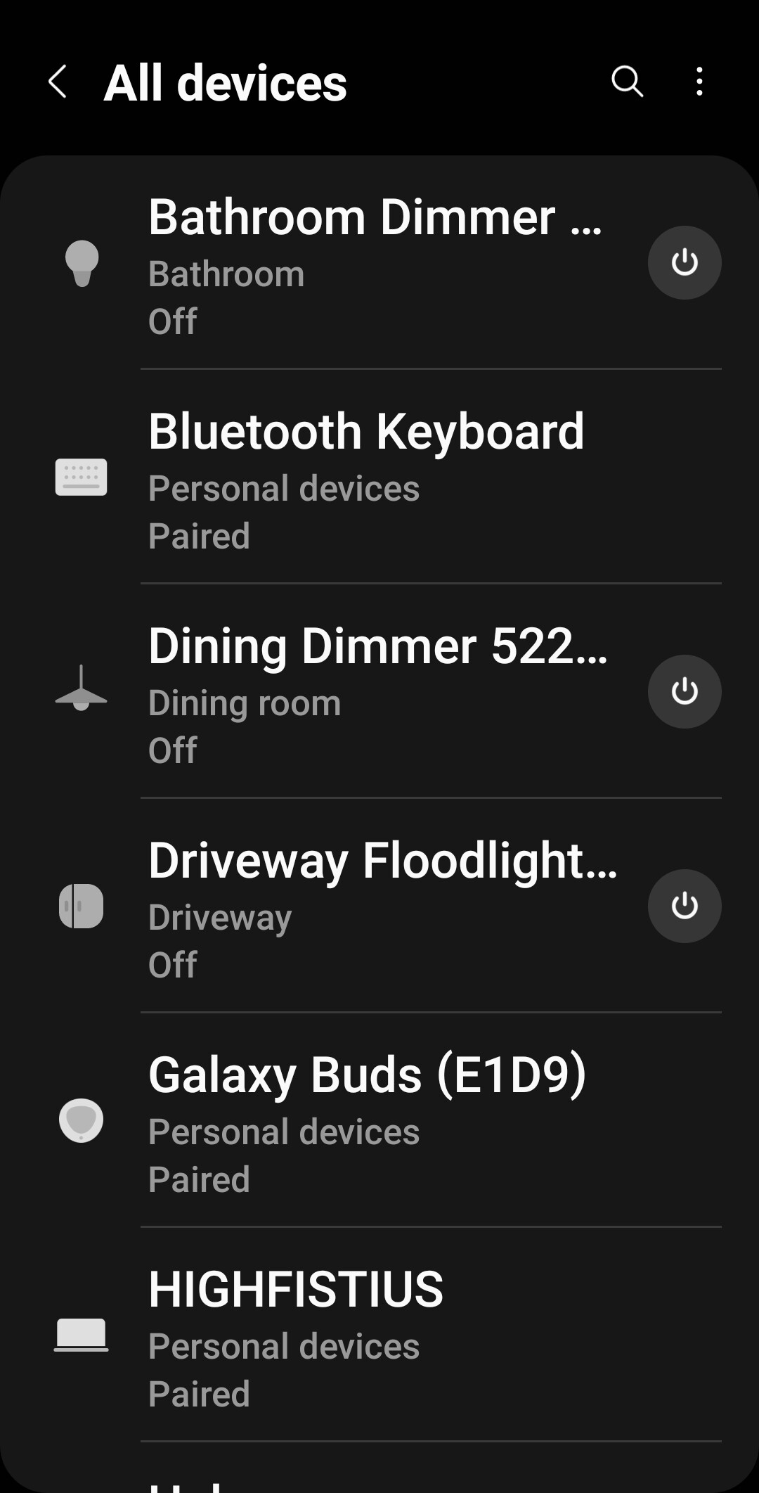

yes this is the One UI on android. strange though, the lighting group doesnt exist in the room Kitchen, but it exists in the Devices and Media tab… when i was initially playing with @philh30 's driver for the 52525 switch, i recall creating a lighting group, and called it Test. i dont recall where i deleted it though, as it still remains in the Devices list… but not in the ST app itself.
From that screen, tap on Kitchen, then hit All Devices, then hit the magnifying glass to search, then start typing Kitchen in the search bar to see if that group pops up. Tap on the device, then try the 3 dot menu in the top right to go to Edit->Delete.
Correction… type “test” in the search. I was thinking your lighting group was called Kitchen.
nope Test doesnt exist, these are all the devices
ok, found something here… i went and created a new Lighting Group called Next Test, and then went to the Devices Tab, and found the Test was gone…
then i deleted the new LG called Next Test from within ST app, and it still remains in the devices Tab… found the bug i guess.
