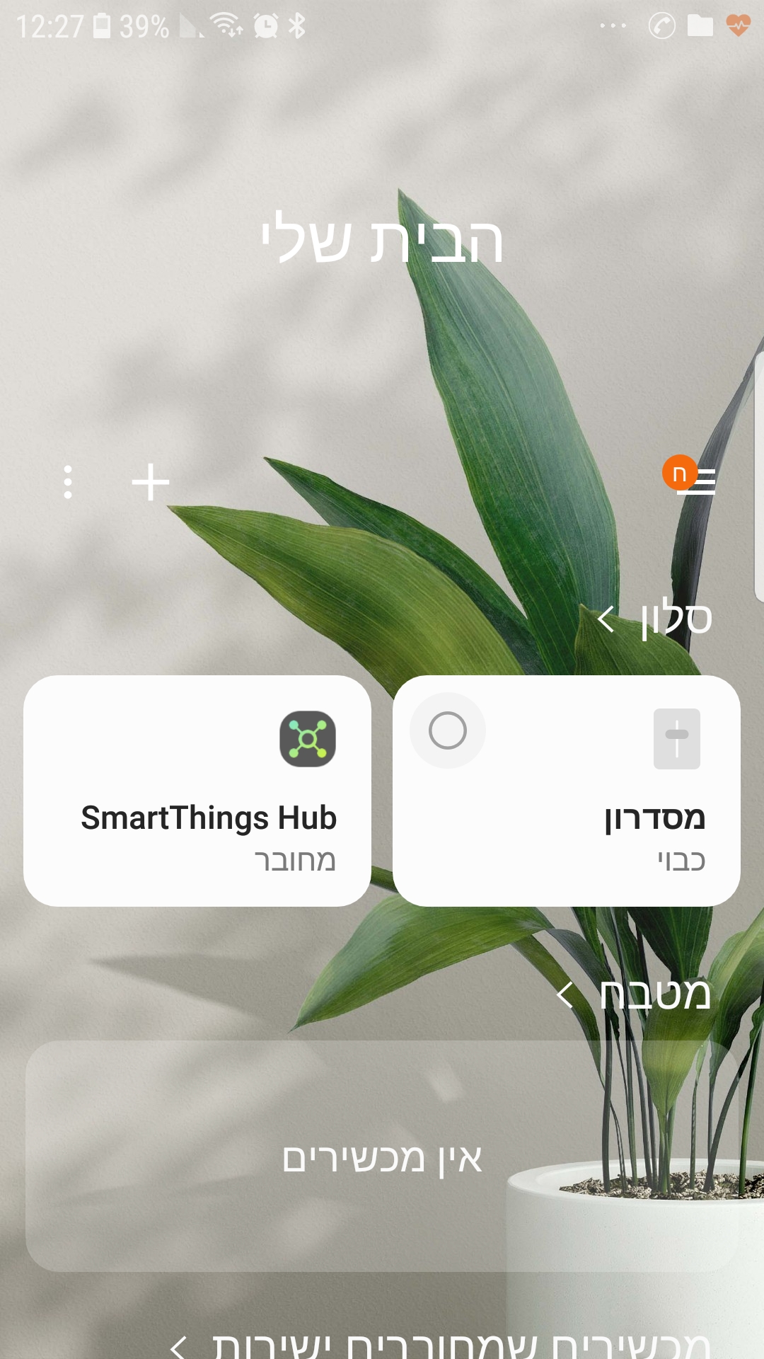

What do you mean the classic app ?
I have the one was already pre installed on my samsung phone is it o.k.?
I attached a picture of the app icon.

Last step, choose the “right” smartthings app.
Go to the the app store (Google or Apple) and choose the one without the dots inside (middle one in my picture, the left one is the app you use, that doesn’t work with most of the non-SmartThings devices).
