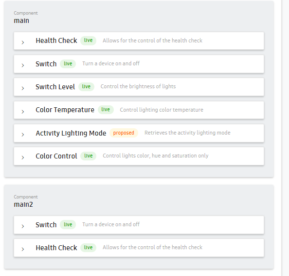

and what if I’m adding a duplicate function like 2 buttons instead of one what do I do then how do i asdress it to another components
is that thes section

I think you don’t need to add secondary health check. if leave new switch at main2 component.
And you need to your device application to handle switch capability of main2 component.

    cap_secondary_switch_data = caps_switch_initialize(ctx, "main2", NULL, NULL);
    if (cap_secondary_switch_data) {
        const char *switch_init_value = caps_helper_switch.attr_switch.value_on;
        cap_secondary_switch_data->cmd_on_usr_cb = cap_switch_cmd_cb;
        cap_secondary_switch_data->cmd_off_usr_cb = cap_switch_cmd_cb;
        cap_secondary_switch_data->set_switch_value(cap_secondary_switch_data, switch_init_value);
