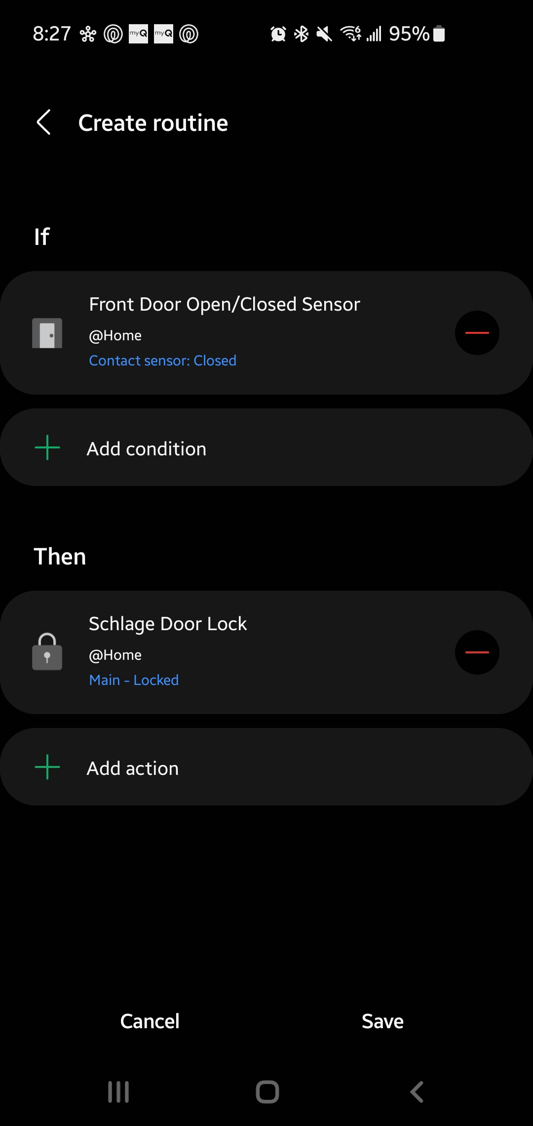

I just recently made a routine on each of my schlage locks to lock if it has been unlocked for one minute. My routine also checks if my door is closed.

Any way to trigger the auto lock after a contact sensor confirms the door is closed using the edge driver?
Lock the door automatically:
Or activate Auto lock:
