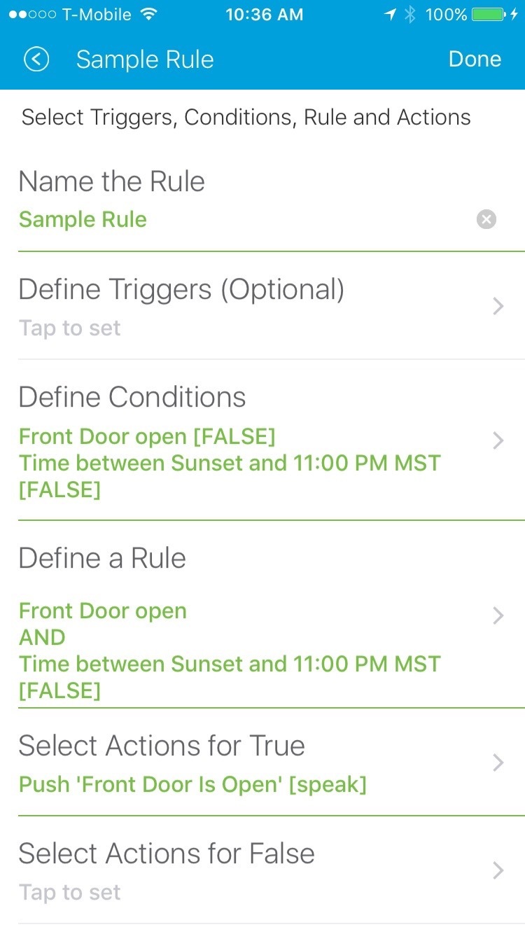

Not quite true. The vast majority of Rules have very simple logic, such as “Front Door Open” AND “Time between sunset and 11 PM” . And, text descriptions play no part in setting up a rule. A rule is constructed by selecting the Conditions that one has already setup up (e.g. “Front Door Open”), and by selecting the two logical operators AND or OR. It is also possible to construct complex rules with parenthesized sub-rules, but this is an advanced feature that most users don’t need.
Below you can see the Conditions selected, and on the right the Rule defined. Below is the main page of the Rule once it’s setup to send a push and speak a message. Note that the [FALSE] shown in the display reflects the current state of those Conditions and Rule truth.
