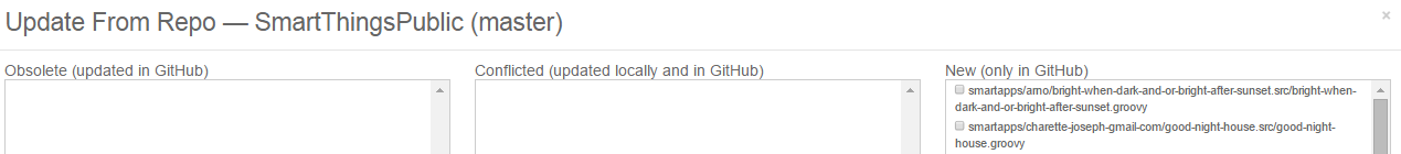

in the IDE under Smart Apps click update from repo
Chose the repo
You have 3 sections, you are interested in the last one “New Only in Github”
Check the one you want and then click execute update down at the bottom. You also have a check box to publish if you want to publish it without editing as well
