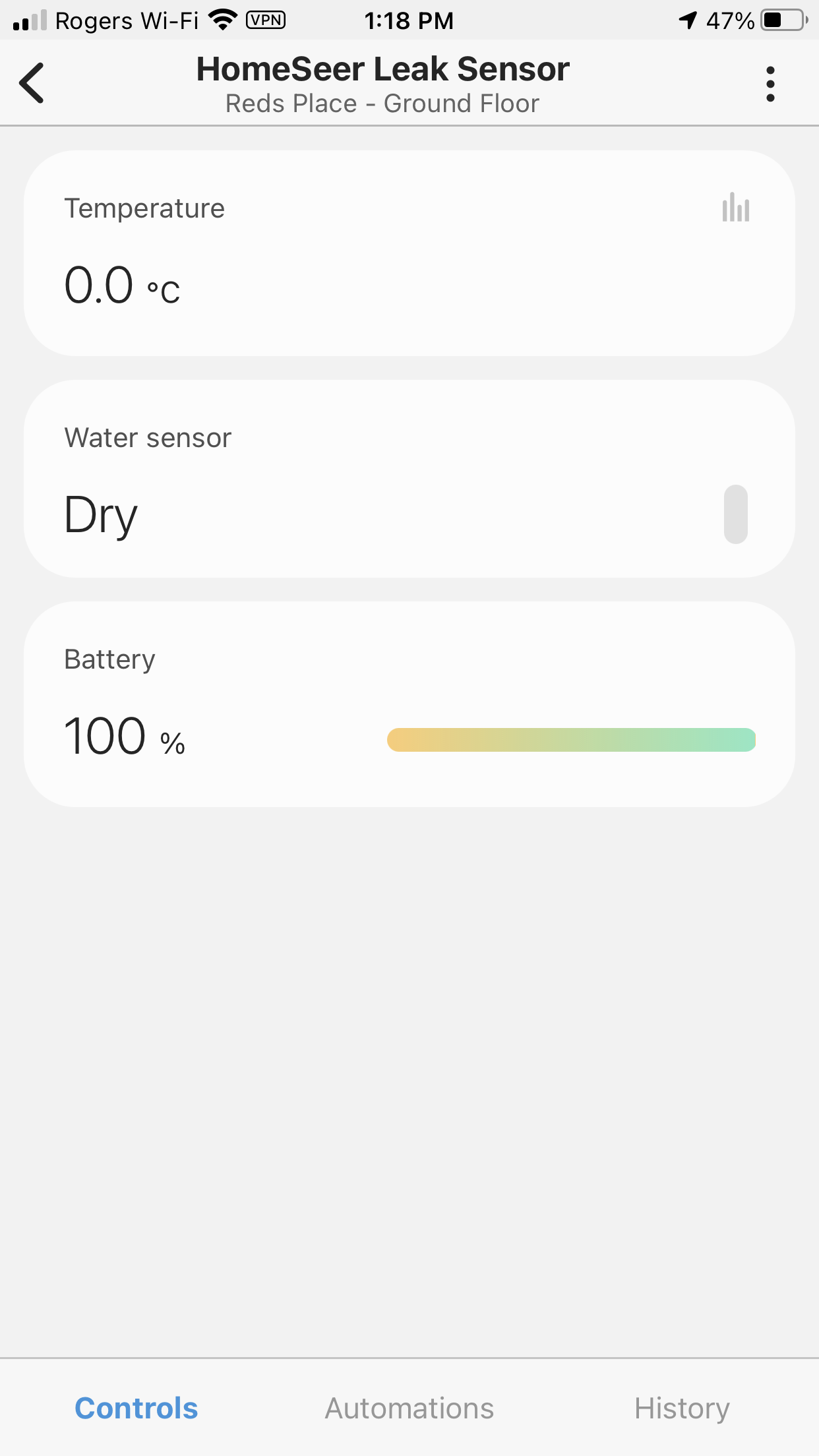

Quick question on the HS-LS100+ DTH - is there a way to force temperature to report in F or C?
I have a US Samsung acct and my hub and almost all sensors report in F (found out thru Samsung that the weather reporting is driven by the where your account is created). For some strange reason the HomeSeer DTH for the leak sensor is reporting temperature in Celcius.

Hi Kevin, thanks for getting back to me. It’s a bit of a head scratcher, I checked location setting in IDE and temperature scale is set to F. All other temp sensors and weather display in F.

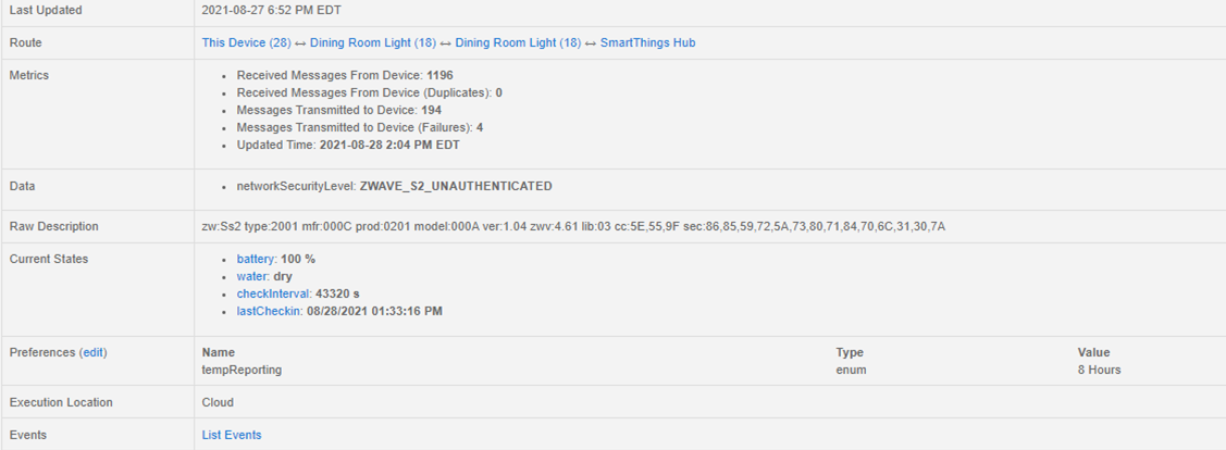

- I noticed in the device states reporting there isnt a temperature value… could this be the issue?

The odds of your temperature being exactly 0.0°C seems extremely unlikely so I’m thinking you’re seeing that because the device hasn’t reported the temperature yet.
Most of HomeSeer’s devices don’t send wake up notifications when woken up manually, but if the DTH has a refresh command that requests a temperature report then pushing the physical button on the device while dragging down on the device details screen might force it to request a report.
by device details screen - do you mean in the mobile app? I have tried resetting the Temp Reprorting Interval to 1 min and pressed the button near the battery and LED while refreshing device screen in app.
It detects moisture right away, but still displays 0.0C as temp…
Weird - Went to debug screen… forced a report and did a battery pull, Now its reporting 80F.
Thanks Kevin.
Solved.
