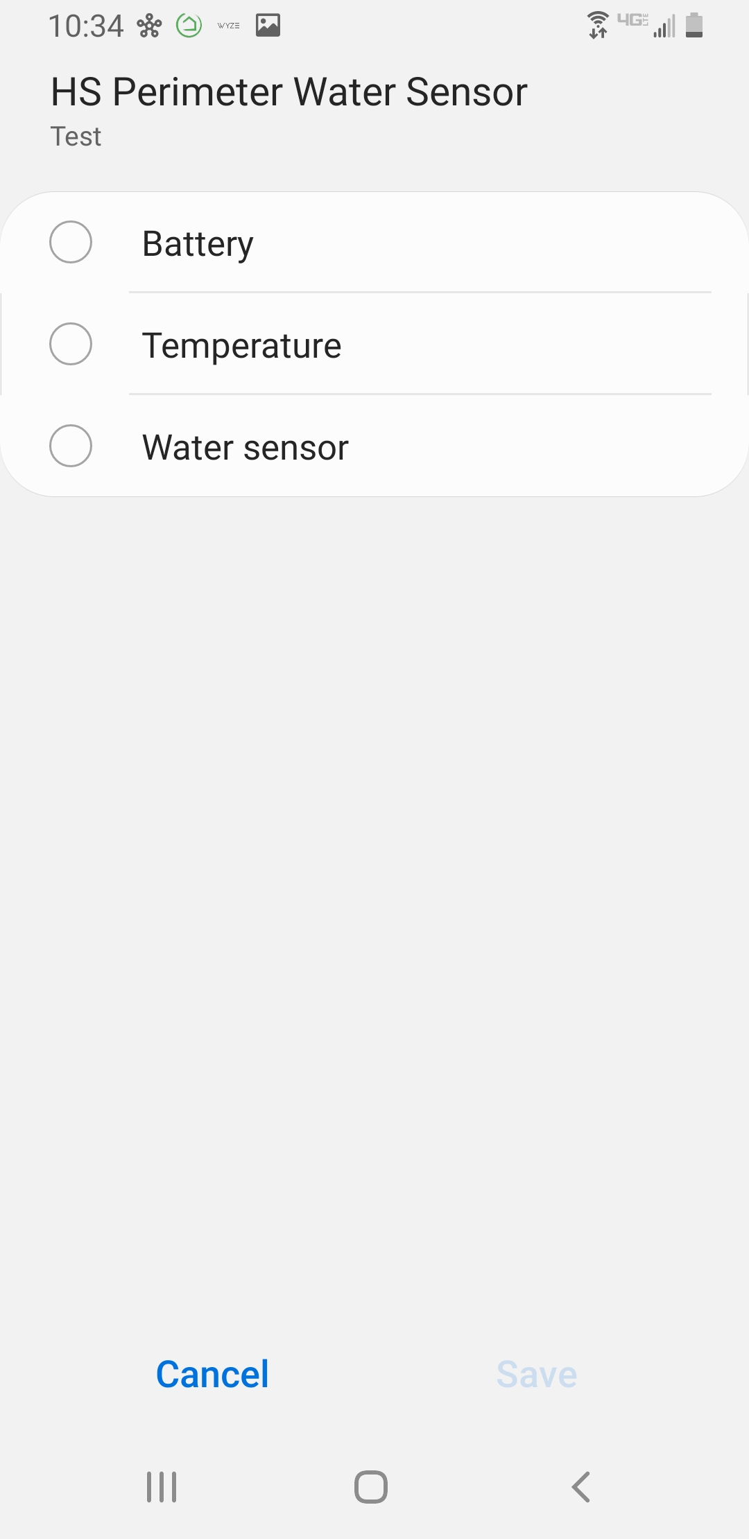

This device shares a fingerprint with the HS-FS100-L so if you have both handlers installed you need to put // in front of the fingerprint line in the other handler before joining the device. If you don’t do that it might get assigned the wrong handler and due to platform caching issues it could still show the wrong UI after changing the type field.
When the device is powered by batteries and you change a setting the device won’t receive it until the next time it wakes up which could take 24 hours. You can manually wake the device up by pushing the physical button, but it doesn’t notify the hub that it’s awake so you need to refresh the device details a moment after waking it up. Swiping down when you’re at the top of the device details screen executes the refresh command.
Screenshots
