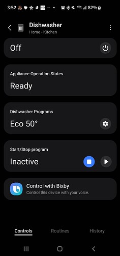

I am using the SmartThings app to control my Bosch smart dishwasher. With the SmartThings REST API I succesfully do the following commands:
  • Turn on the device
  • Set a program
  • Start/Stop program
The problem is with the “Start/Stop program” command (see below) which gives a 200 OK response but does not start the program on the device. Also when I press the play button in the SmartThings app to start the program, I get an error (see picture).
Can anyone tell me if I am doing something wrong?
If not, when will this issue be resolved?

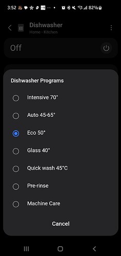

The ‘Turn on’ and the ‘Dishwasher programs’ settings in the app work with the machine: ‘Turn on’ turns on the dishwasher and if I select a dishwasher program, that program is also set on the dishwasher. Do you know what network issue it can be?

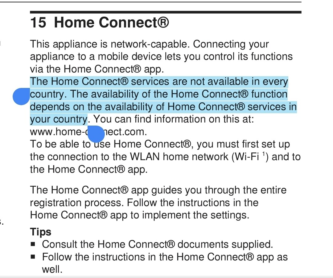

I’m not sure where that preference is, or where you got that documentation. My owners manual says
On Benchmark series, when I set up dishwasher, first time I connected to the app, pop up came with question to have this permanently on.
This might be the issue
That screenshot is from my user manual.
