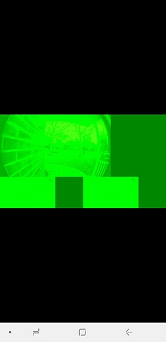

As above really, I’ve connected my RD Pro to smartthings but I’m getting a green distorted picture on the video feed. Signal strength is fine, picture through ring app is fine.

I see the same thing intermittently, using the RD Pro handler for my original Ring. If I end live view and try again it sometimes goes away. Same as you, I haven’t seen the issue when viewing through the Ring app.
Report is to ST support, it’s a bug with their mobile app, if enough folks report it they may fix it. It isn’t unique to Ring but also from other cameras like Foscam.
In the interim you can reboot your camera, router, hub and phone and that may fix it temporarily. It has something to do with the latency of the devices in the chain so rebooting everything usually helps. But the long term fix is for ST to patch their mobile app video player and make it hardier.

I understand your frustration but do report it to ST, it’s a simple fix but we need enough folks to report it so they can fix it. Take a screenshot and send it to support@smartthings.com
Installed a new Ring Doorbell Pro and having the same issue. In my case, it is persistent and I have never seen a clear feed through SmartThings.
It looks like you’re using and Android phone. You may want to try this, reboot your camera, hub, router and your phone (in that order). It works for some folks.
