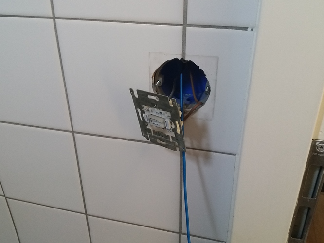

Now I am pulling a neutral wire to the switch.
