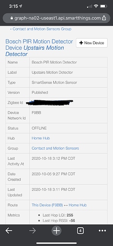

Just to keep the story going, on Wednesday, a day after I received the response from ST saying to buy their brand motion sensor since one of my Bosh models was showing offline after migrating, I received an email for SmartThings Maintenance - SmartThings Hub 2015 (v2) and 2018 (v3) Firmware Update - 21 October 2020.
After this update…my Bosch sensor has returned to normal. Hasn’t been offline once since.
