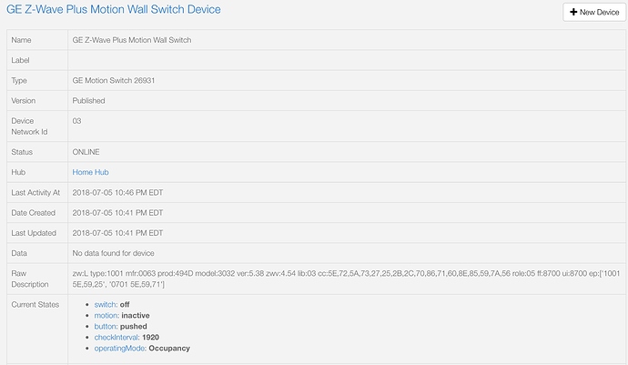

What is a bit funky though is that I can find some evidence of the device when using the SmartThings web interface:

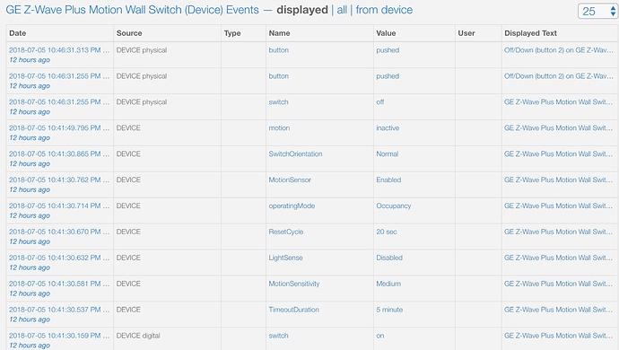

And logs. All the inputs/motion the switch saw last night were captured:

I have actually taken over the development of the DTH. However, the current one you are using DOES work with SmartThings effectively and I have been using it in my environment for a couple weeks, with adding a new one just yesterday.
Right off the bat it appears you didn’t name the device. If you go into your mobile app, click the gear in the upper right corner, you should be able to do that. The label is typically what is used within the rest of SmartThings to reference the device. It should have been named when you first integrated the device.
