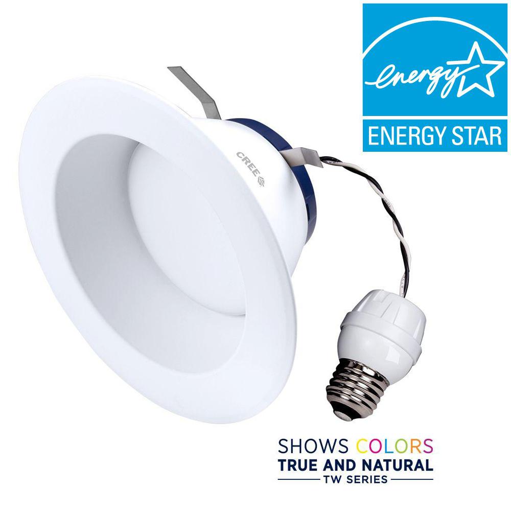

I have found that this dimmable Cree LED is almost identical in color to an incandescent light when I did a side by side test.
I have also found that the Philips SlimStyle LEDs buzzed quite loudly when used with the GE dimmer and the Cree did not but you can get them for $1.97 each at Home Depot right now. I believe it is in store only though.
