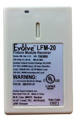

I guess the only problem of doing it yourself vs MyQ is that you will have to buy the LMF-20, then the tilt sensors. I n my case, I have two doors so that would be around $200+
MyQ is about the same or less. But I hear you, with no official support is hard to sell it.
There’s also the fact that the LFM relay is only UL listed for light fixtures, not hotwiring a garage door control. The MyQ meets UL 325 safety standards for unattended operation of garage doors. Not everyone will care about that, but it is a legitimate distinction.
For the MyQ install you’ll need the $102 hub, which comes with one door control. Then you’ll need to spend 50 bucks on a second one. I just converted mine over a month ago using the link I shared and it cost me $149.I bought the following tilt sensors
and then two of the LMF-20 boxes
Basically its a wash except the fact that its completely controlled through Smartthings or whatever other Z-wave hub you may want to use and your not having to rely on development to get it working.
I just got mine hooked up on Friday. I just bought a ecolink door sensor Here Stuck it on the side of the door and it works great. Then I did the LFM and mounted it to my ceiling. I hit the button in the app and I can now finally open my door from the bottom of my street :smile: Thanks ST for that. I also get alerts if the door is open past 10pm or if it opens after 10pm.
