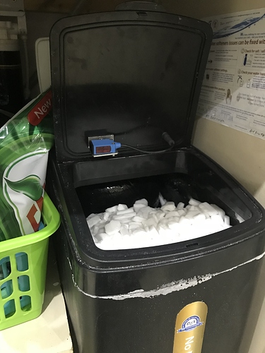

I’m using this particular application to detect if the salt in my water softener is low. It then reports back to ST.
I have designed a custom HMI for my house in codesys (PLC software) running on a raspberry pi. All the device data from SmartThings is used in my application based on the Open Dash API.
See the link below to my project post:
I can design a status on one of my screens for the water softener based on this dry contact and alarm on my HMI/announce over LANNouncer when the salt is low. Here’s 2 pics of the sensor installed.
