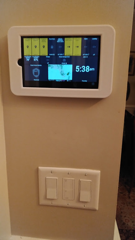

Ordered three of these from Woot (32GB, @ $39). Two have come in already. I used your script on the two that have arrived. They both were loaded with Fire OS 5.4.0.1. Lot’s of error messages initially, but the final result was Amazon ads no longer pop-up and all the required software was loaded. Sweet! Did not need the 32GB models but that was all that was left on Woot. Will try again with Woot for a few backups if I’m lucky enough to see them when they get listed.
Each one is running Fully Kiosk, Actiontiles, and Dakboard. No issues with all three of thes great programs running on the Fire as well. Wallframe from MotifEtc. My only issue with the wall frame was that the opening is only to the left which is 1" away from the wall. Plugging in the Fire was a pain. Would be nice if he sold a right-hand model as well
PS, the wife has claimed the 3rd one for her personal use when it comes in…
Attached a couple of pictures of final wall mount of one of them
