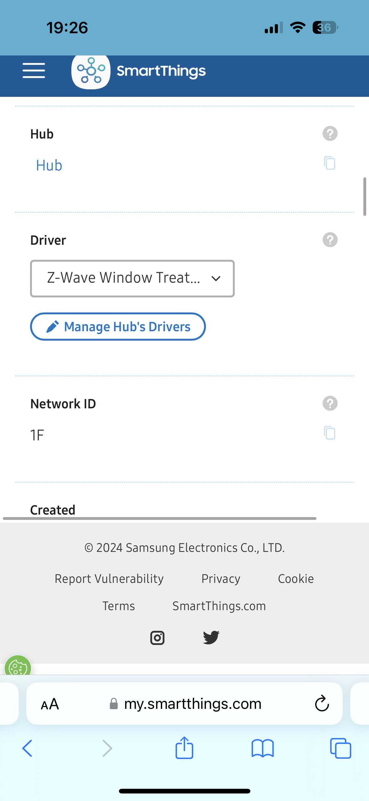

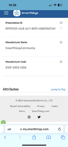

You need to log into the ST Advanced Web App and look up the fingerprint (Mfg Code/Model) and post it here. If you can’t find the driver, then the fingerprint of your device is not included in the driver fingerprints or there is some other issue (like it’s all zeroes due to improper pairing).
I know Mariano has already contacted you directly, but for anyone else coming across this thread later, although the Fibaro shutter 3 is advertised by the manufacturer as being suitable for some types of garage doors and gates, it uses a different set of Z wave command classes than Mariano’s garage door edge driver. So it wouldn’t work even if the fingerprint were added.

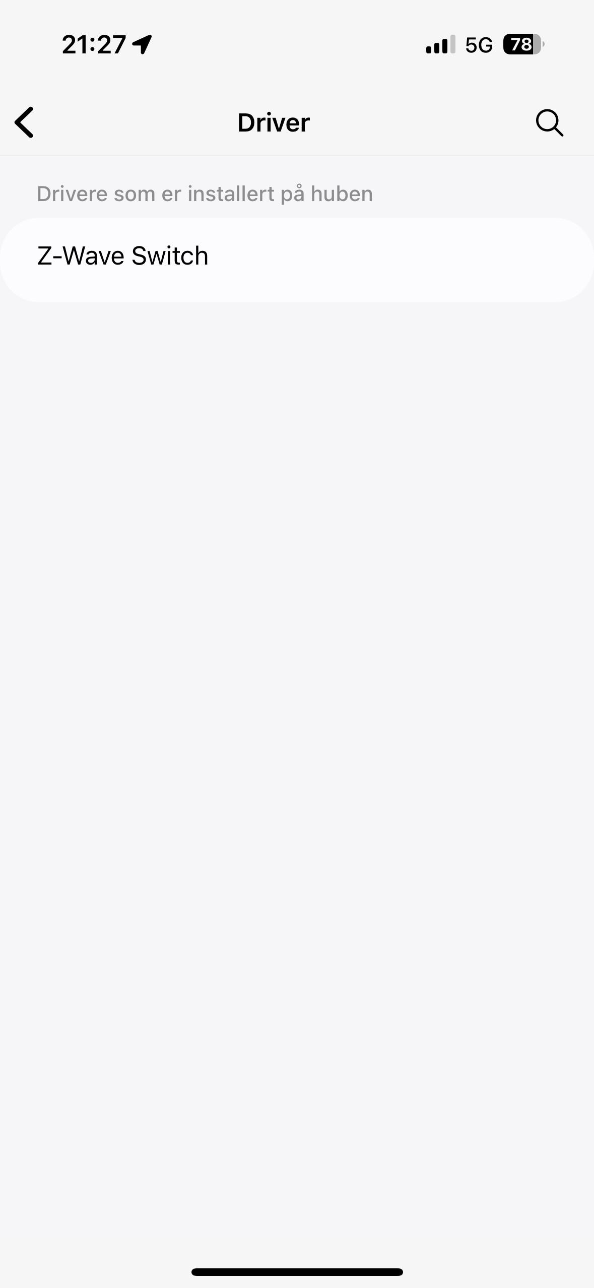

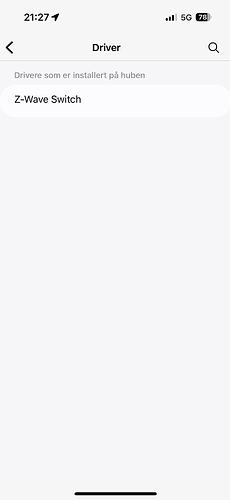

I have tried but it would not work. It makes a sound in the garage engine when i pull the button in the ST app, but nothing happened with the garage door
