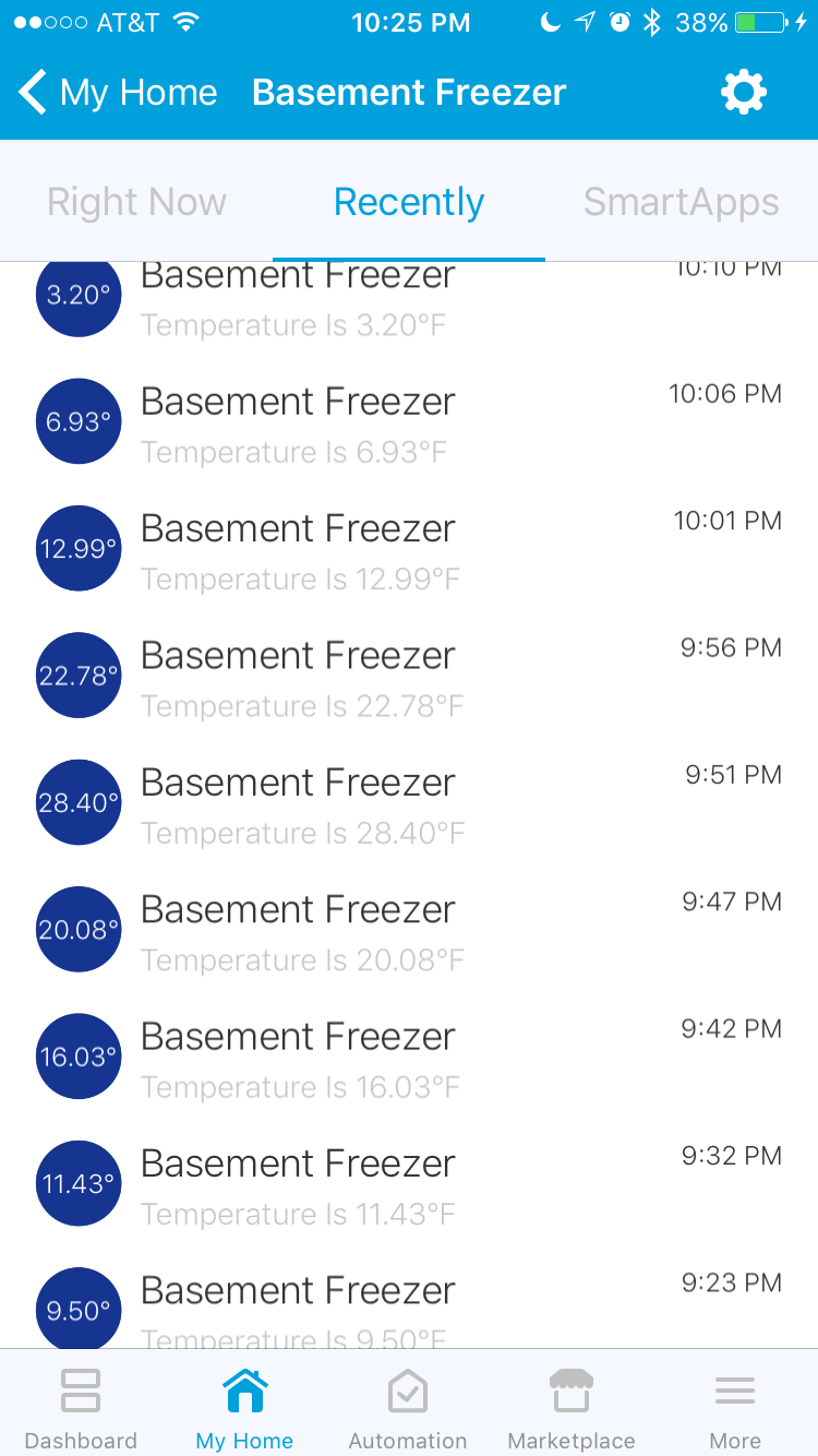

Hello, I recently connected the Fibaro FGK-101 with a probe in my freezer. For whatever reason, I get quite some temperature variations that I doubt are real. Does anyone have experienced a similar issue? I understand there could be some due to the auto defrost function of the freezer but it seems a lot and very quick (see attached screenshot). It might also be related due to the low temperature but I would not expect this picture. Thank you in advance! Cheers, Jens

Thanks for your response. I agree that it’s still in the safe zone and I created an alert once it goes above 20 F. It happens once in a while but drops the next minute again. Still confused as to why.

that is the kind of twitchiness I would expect from naked bulb sensor - is that what you got? It’s not really too bad. Door leaks, air currents, and who knows what. In a lab environment that sensor might be immersed in a bottle of glycol to give it some thermal mass and reduce the noise.

Note the DS18B20 must be connected before power is made. Also external 4.7Kohm required - maybe you forgot it. Reading directions is a good thing, so I am told, often.

You may have a counterfeit DS18B20. I don’t understand why manufacturing douchebags would choose to fake such a cheap sensor, but it’s a thing. I don’t have advice how to tell - just get some from a different source and try those.
it occurs to me that maybe your freezer (and fridge if combined) is mostly empty. If you put a bunch of ice or other mass then it will slow down.
