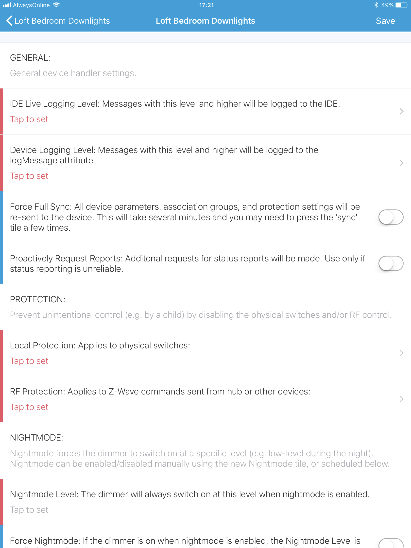

Wonder if it might have to do with the Parameters that are showing up as Red by default as per picture:

Ok, thought you meant that. But I am very unfamiliar with what the live logging is meant to show. When I tried to update the Preferences page in the Smartthings App previously, it kept not allowing me to change anything and saying that I needed to check my inputs. Assuming it will continue to say that, what might the Live Logging page show to help?

Do you know where I can get the recommended defaults for each of the Preferences?
Think I’ve found the recommended defaults for the Preferences: (agree?)
And this was the result in Live Logging after I set the Defaults:
Sorry for my rambling. I just went to the house (I don’t live in it during the build) and used the physical switch to turn on and off, and the Smartthings App tracked the status of the light perfectly! Not sure exactly how what we did solved it, but just glad it did. Thanks again, Robin.
