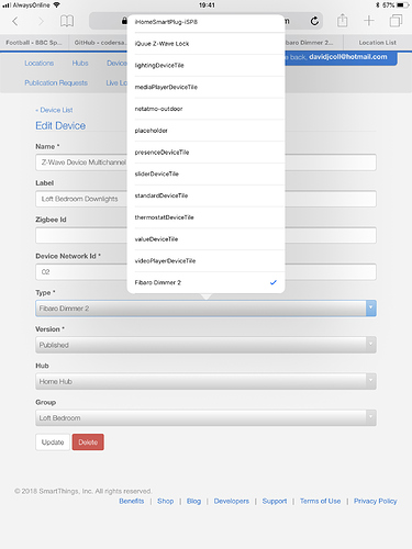

The electrician has installed 6 LED 8 Watt Downlights (Aurora E8s), and I have a Fibaro Dimmer 2 and Bypass connected. Managed to get the Internet hooked up today, plus the Samsung Smartthings Hub.
I’ve managed to copy and paste the Device Handler code from Codersaur and have published this ā€˜to me’.
In Devices I assigned my Fibaro Dimmer 2 to Device Type equal to ā€˜Fibaro Dimmer 2 ZW5’.
I then logged into the Smartthings App and was able to turn the lights on and off and dim the lights.
My question is how can I be sure it is actually using the Codersaur Device Handler and not something else. Is the fact that the Device Type is showing as ā€˜Fibaro Dimmer 2 ZW5’ proof that it is using this Device Handler?
Here is a screenshot from the Smartthings Classic App. Do you know if this is what I should be seeing?
Thanks. Is that in My Apps in the Smarthings App? If so, it is empty? I saw something about the ide possibly publishing to the wrong location, but can’t seem to work out how to rectify that.
Figured it, thanks. It is the last item in the ide type drop down. Think I’ve got the right one now!
