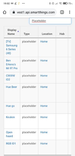

Thanks for the info, but I noticed something different. Can’t find it in this topic with Find.
I see at Type so called “placeholder”.
Here how it looks, one picture with the duplicate name next to the functioning device, the other filtered on “placeholder”.
I will try to remove the placeholders and see what happens.
Grtn Ben
placeholder is for devices which are connected using Cloud to Cloud integrations using the new ST app. If you delete then you will need to reconnect them. They don’t have any impact on zwave or ZigBee
Tnx for the info.
Thought delete it would solve my ghost devices.
DO NOT DELETE or otherwise mess with placeholder devices unless you want to fix whatever it breaks.

Can’t tell what is broken now, I removed the placeholder devices.
But the duplicate / ghost devices are gone now in the app.
