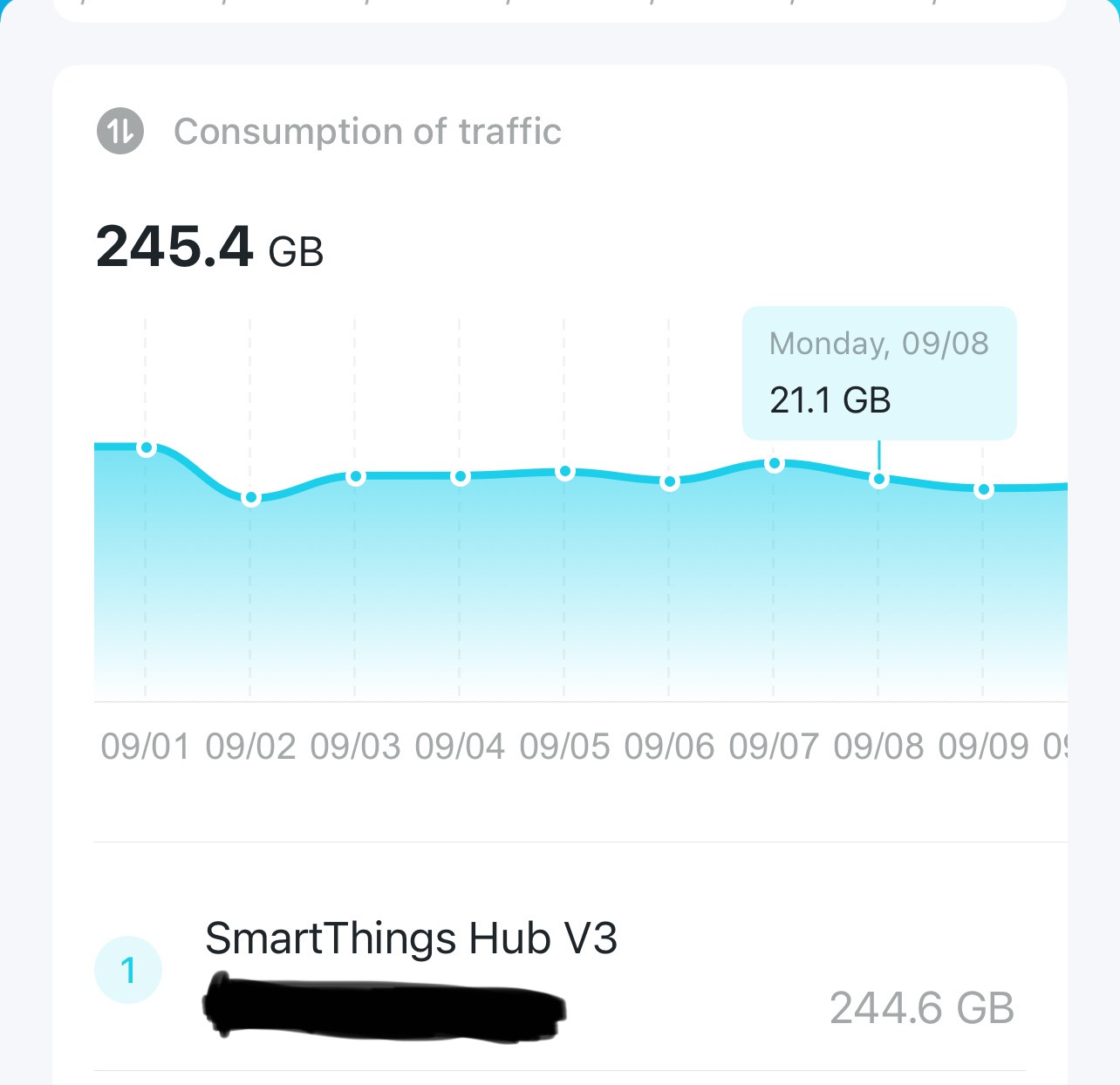

I was away for a month only to come back to find the Samsung SmartThings was consuming on average 20gb of data a day…when I connected it first I noticed the data consumption but I thought it was a firmware update…can anyone help me out with this…else I’ll just have to trash it. It’s not like I even have anything connected to the hub itself. There is absolutely nothing connected to it just the hub in the Ethernet switch…
