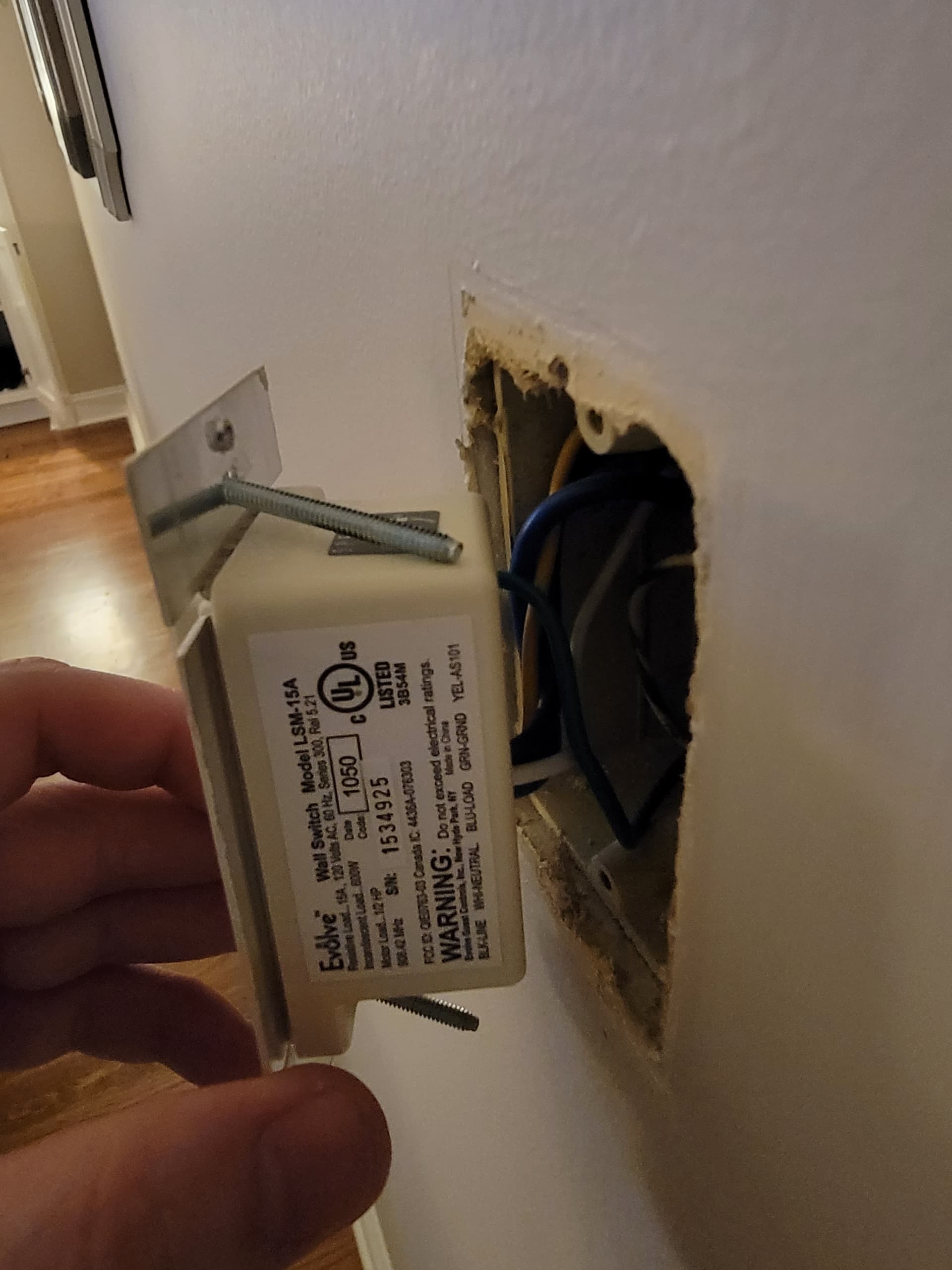

Just moved into a new home and stumbled upon a few Evolve LSM 15a zwave switches. Anyone use/ used these in the past? I can’t figure out how or even if I can connect these to my SmartThings hub.
A quick search on the forum shows people have used them in the past, though it looks like depending on the age they could be from back when instant updates were locked behind a patent. Try using general exclusion to reset them and then try to include them. They’ll likely be supported by the generic z-wave switch DTH.

From a google search it looks like exclude is 2 tabs on the bottom paddle and an include is 1 tap up paddle.
