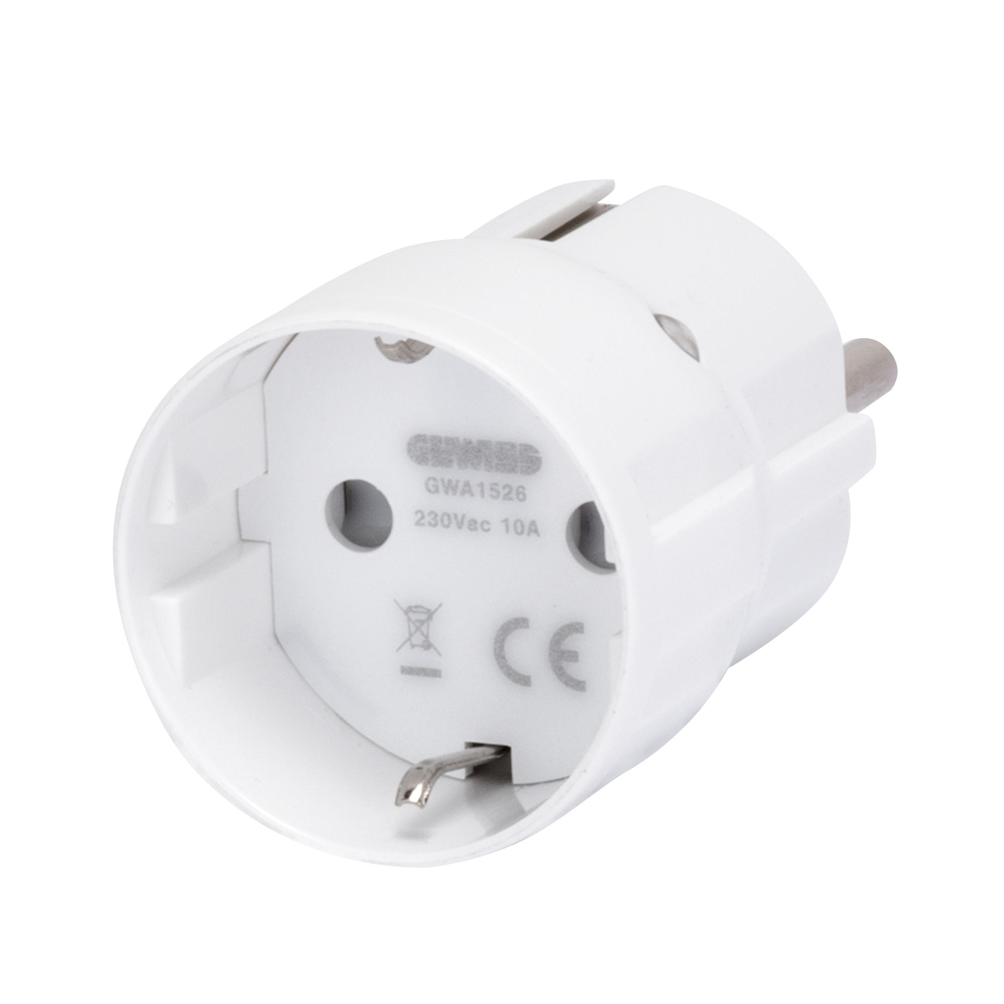

Gewiss makes one, but I don’t know where to buy it
So check with them, and also check with Develco to see if they are selling samples of the socket type you need.
@anon36505037 - Yeah, I know that many OSRAM products work with ST (I have the LED bulbs and the strips). That’s why I assumed that the plugs will work as well. I assumed wrong. :neutral_face:
@JDRoberts - I’ll look into the Gewiss and Develco plugs. Maybe I can get them in Germany. Thx, mate! :+1::wink:

The Develco and Gewiss plugs look almost identical to me.
Develco is a white label manufacturer, so quite possibly the Gewiss is just a branded version of it.
Their specs look pretty much the same, too.
