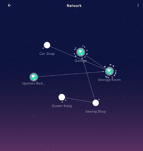

In the AWA is there a way for me to tell if the other 5 sub hubs are functioning as z wave sub hubs?
Thanks for your help!
They act as Z-Wave repeaters and are not nodes on the network so they don’t show up in the device list. In the old IDE we used to be able to see the route a Z-Wave device would take to get to the hub and you would see them listed if a device’s route went through one. There is no way in the AWA yet to see the route. The only way I know of right now is to change a device’s Edge driver to the Z-Wave Explorer driver which provides detailed Z-Wave info for a device. Only thing about doing that is that if a device is used in a Routine, it will be removed from the Routine since the Z-Wave Explorer driver won’t have the same capabilities defined.
