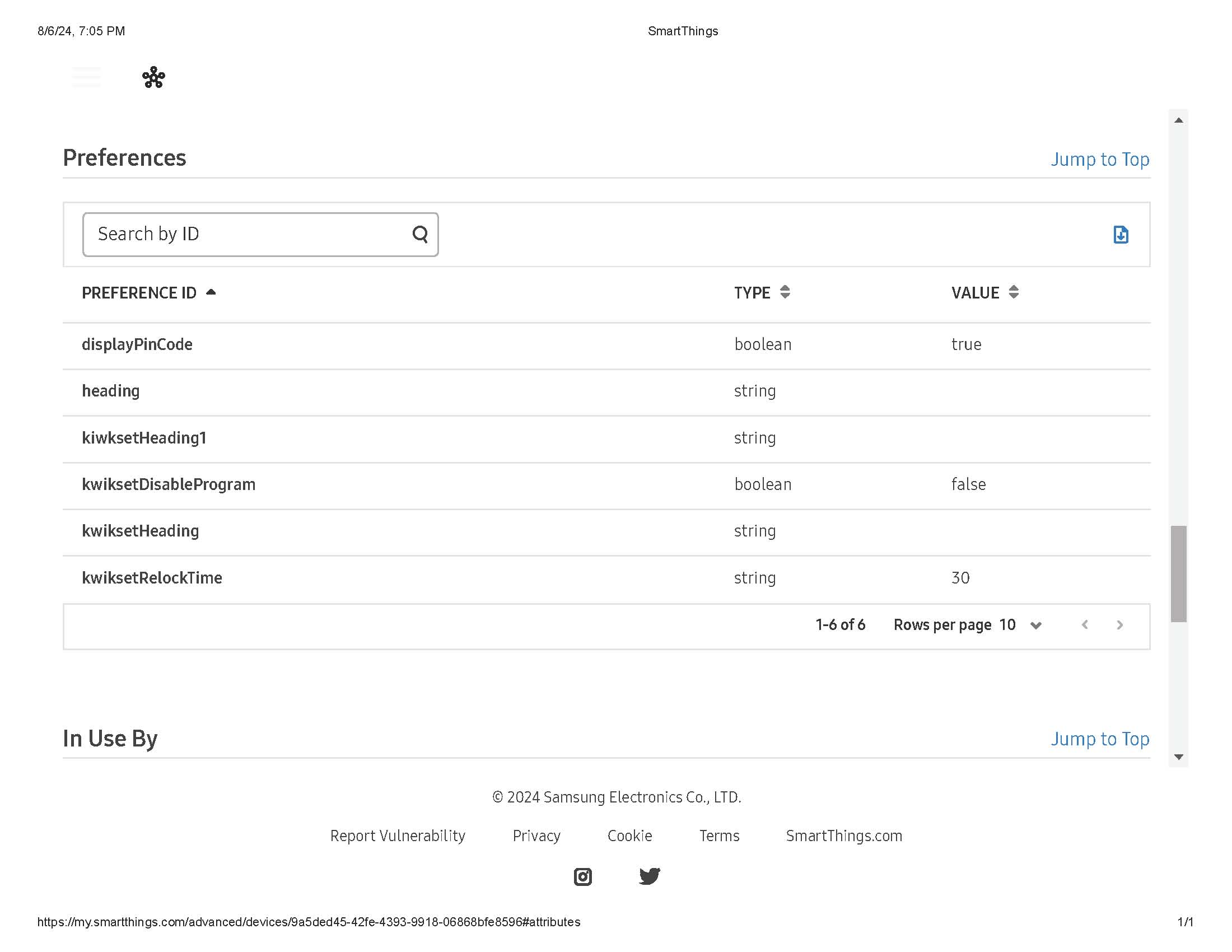

Please post a screenshot of the device detail information from the ST Advanced Web App.
Attached is a screenshot of the device detail information from the ST Advanced Web App.
(Attachment SmartThings.pdf is missing)
Doesn’t seem to be there. Save it as a jpg and upload the image.
Attached are screenshots of the device detail information from the ST Advanced Web App
(attachments)
All the device capabilities look good, but none of the values are populated. Did you change from the stock driver to the rBoy driver without re-pairing the lock? If so, I would exclude the lock and re-pair it. It should pick up the rBoy driver automatically.

I don’t see any lock/unlock events received by the hub. Again, it appears as if the lock isn’t generating messages or they are not reaching the hub.
Since both drivers are exhibiting the same behavior, it’s got to be something with the lock and/or its location. Is this a brand new lock? It appears this lock supports Z-Wave Plus which means it likely supports S2 security. Did you scan a QR code to set it up or manually enter the DSK when prompted during set up?
Short of placing the lock directly next to the hub to verify that location is not an issue and barring that it’s not an S2 issue, I’d say there is something defective in the Z-Wave module of the device.
The driver is definitely stuck in a loop of trying to initialize the lock set up, but never gets any replies.
It’s not a new lock but it was functioning with a Vivint hub at my daughters house. I set the lock up manually since I didn’t have a QR code for it.
I’ve excluded the lock four or five times, I’ve reset it to factory settings three times. Each time the user codes are setup and work. It pairs normally with smartthings,
but the app icon says “Connected” but when clicked on it gives me the “hasn’t updated” message everytime. I have 4 Yale Real living locks that function
very well. This is my first Kwikset smart lock. Your help is much appreciated.
Hmmm, did it ask you for the DSK and you bypassed adding it? Did you add the lock by doing a “Scan Nearby” or picking the specific model to add?
If you skipped adding the DSK, that could be part of the problem. The lock might be sending/expecting encrypted messages or vice versa for the hub.
Just to clarify, the Aeotec siren is mains powered but it may not support FLiRS buffering. How can someone tell? Google is being singularly and circularly unhelpful, most of the results return this page and your post about needing a buffering repeater, plus Aeotec’s manuals which all state “do not poll FLiRS devices” in their troubleshooting section.
I have no problem with this driver, using it with different Kwikset 2 locks, but as we all know ST can change that with no notice and I’d like to be a little more bulletproof if I can be. If it’s a matter of suggesting a particular plug, for example, then I’ll put one on my shopping list for the next time I need one.
Maybe because your 4 other locks were set up correctly and this one isn’t? The fact that it appears to be unresponsive although the hub is trying to talk to it seems to indicate that.
Or maybe because your 4 other locks are a completely different manufacturer, since you said they’re from Yale and this is a Kwikset?
Either way, being nasty to RBOY isn’t going to help you.
