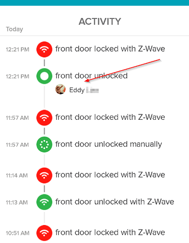

@RBoy I have a quick question regarding the august smartlock, does the smartapp/device handler able to know who unlocked the door?
More specifically:
It does check the door state before unlocking. Looks like in your case the door signal isn’t reaching the platform fast enough.
