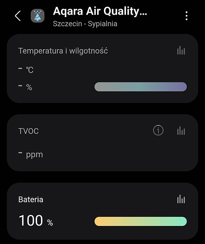

Hi, thank You. I add that driver and when I add device first time with qr code I get ppm, humidity and battery state (100% it’s new device).
Next I try to add second time to get temperature and I have only ppm value and battery (56%). I can’t fix that.

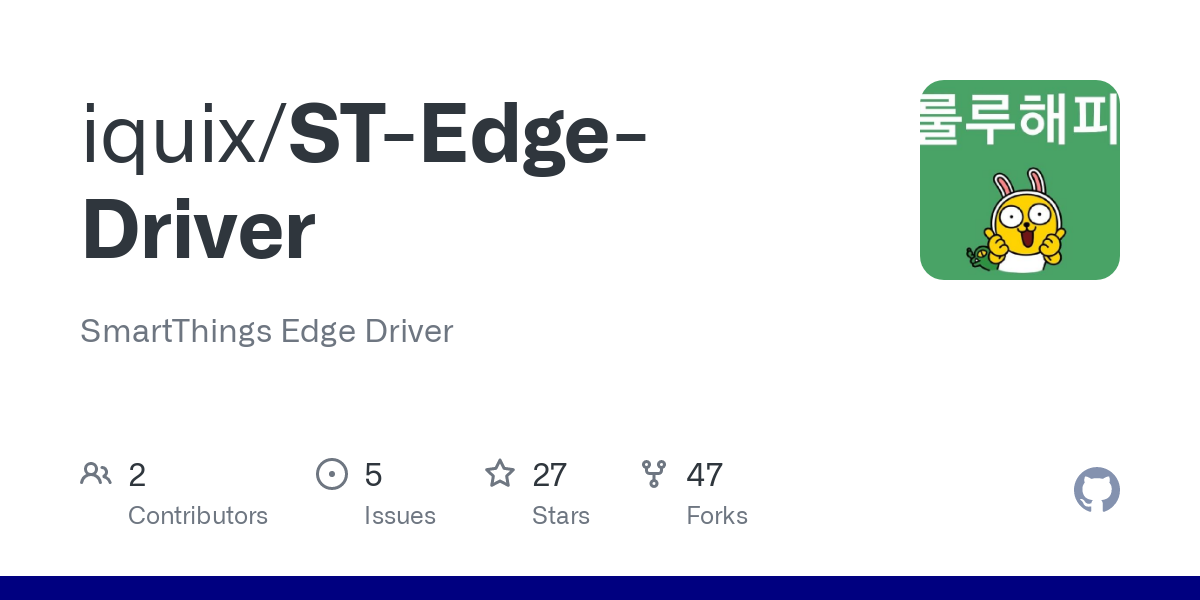

Edge Driver URLs that have “Callaway“ are the ones that you use after you have already subscribed to the channel. They won’t work for people who have not yet subscribed.
Instead, please share the invitation link, which will have either “bestow“ or “invitation“ in its URL.
In this particular case, here is the invitation link for the @iquix edge driver for this device:
Edge Driver Installation Channel URL :

The humidity is not showing up :thinking:
When did you pair it? Has it never showed humidity or is that a recent problem? Which driver and which version are you using? @Tin_Hwee_Wang
Just install. Been a day so was wondering it is still loading.
Ok, so that’s the exact same driver I’m using. Doubt your device is faulty, but check these:
  1. take the device very close to the hub (like 1-2cm, really close!!) And click the top button once. Watch the app at the same time, the values should change. Does that populate the missing value?
  2. did you install/try out another driver before the iquix one? If you did, and you simply switched drivers on the device, it might be worth trying to entirely delete it and re-add it with iquix. I saw on one of the forums that something can get corrupted and so it needs a fresh “add”
  3. unlikely , but … these devices have a design flaw in the battery compartment. Try folding up a bit of paper and putting it between the back cover and battery, so the battery is pressing harder against the contacts.
Let us know what the result is @Tin_Hwee_Wang
