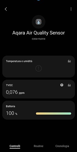

Hi @Zach_Varberg , I’m using your driver, I can see TVOC but no humidity or temp, any advice?

I am seeing something very similar. I have had an Aqara TVOC since about October but I have never been able to to get it working on ST properly… There are a few other threads in the community, but none of the developers seem to be active - so no response…
Was excited to see this thread today… so I’ve gone back to this. Using your driver @Zach_Varberg, I get TVOC and Batt status, but ST never picks up the Temp and Humidity values…

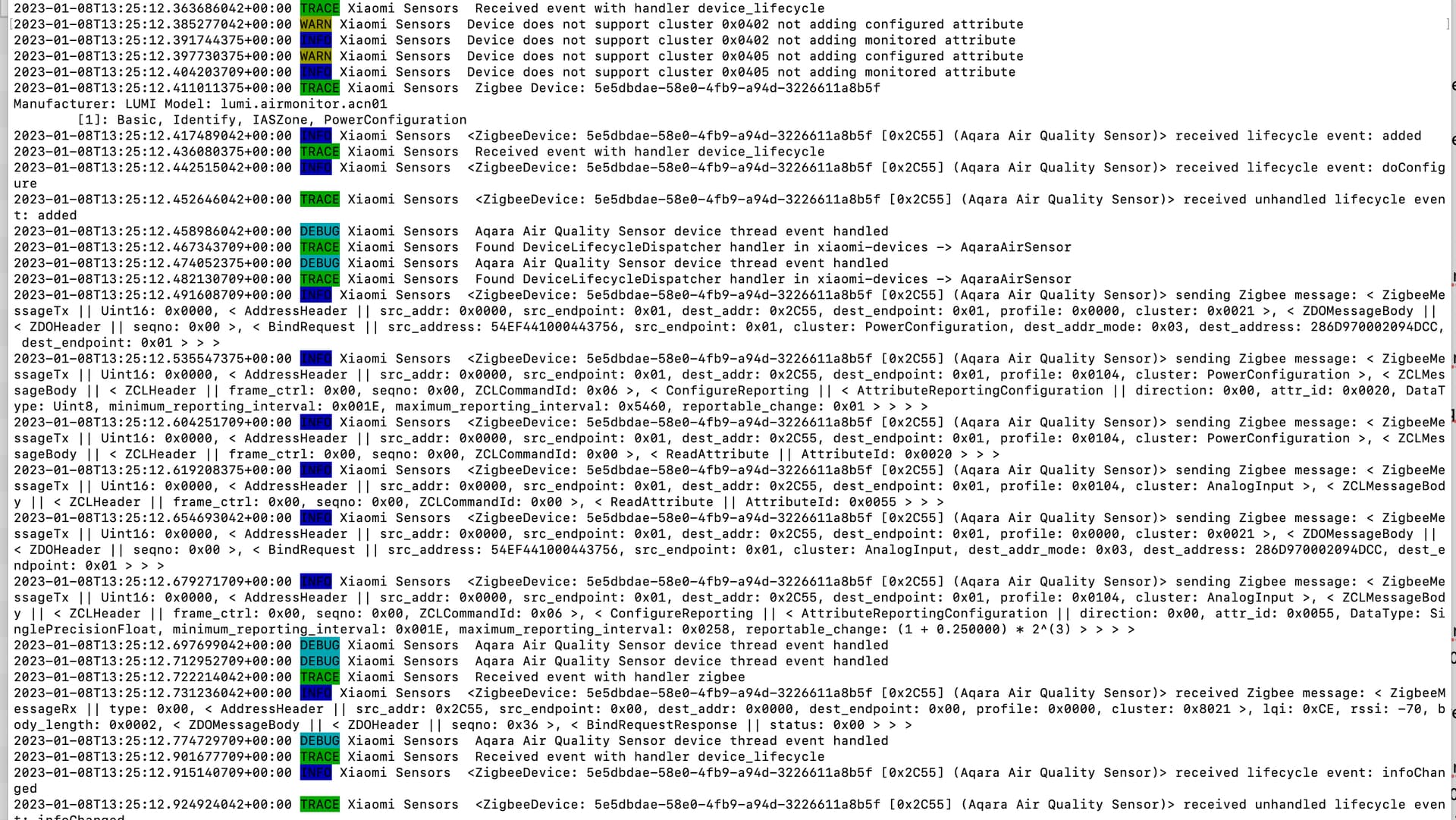

Hi @nayelyz, I received the same Warning Message as @Simon_Townsend, see it:

2023-01-13T22:23:08.990096696+00:00 WARN Xiaomi Sensors Device does not support cluster 0x0402 not adding configured attribute
2023-01-13T22:23:08.996082029+00:00 INFO Xiaomi Sensors Device does not support cluster 0x0402 not adding monitored attribute
2023-01-13T22:23:09.030740363+00:00 WARN Xiaomi Sensors Device does not support cluster 0x0405 not adding configured attribute
2023-01-13T22:23:09.037071363+00:00 INFO Xiaomi Sensors Device does not support cluster 0x0405 not adding monitored attribute
2023-01-13T22:23:09.043156363+00:00 TRACE Xiaomi Sensors Zigbee Device: 829330b7-d869-4090-b7cd-ccce65955dcf
Manufacturer: LUMI Model: lumi.airmonitor.acn01
[1]: Basic, Identify, IASZone, PowerConfiguration
2023-01-13T22:23:09.050768363+00:00 TRACE Xiaomi Sensors Received event with handler _resync
2023-01-13T22:23:09.056567029+00:00 TRACE Xiaomi Sensors Received event with handler environment_info
2023-01-13T22:23:09.071066696+00:00 DEBUG Xiaomi Sensors driver device thread event handled
@RafaelAntonio2022 FYI!
You would like to follow…
This is strange, the cluster 0x0402 corresponds to the temperatureMeasurement.
Here, the logs show these supported clusters, I wonder if this device has them separated into endpoints because I looked for the device on the web and I see it supports temperature, so, I don’t know why it rejects the config for it:
Did you install the driver from the invitation?
Nop! I did for channel link. There is some difference for each other way?
No, we’re referring to the same thing, I meant the channel invitation link.
I’ll check with Zach to see if he has more information but currently, the issue is that the device is responding to the driver that the temperatureMeasurement(0x0402) and RelaticeHumidityMeasurement(0x0405) clusters are not supported.
So, I think this is because the physical device needs a special configuration.
