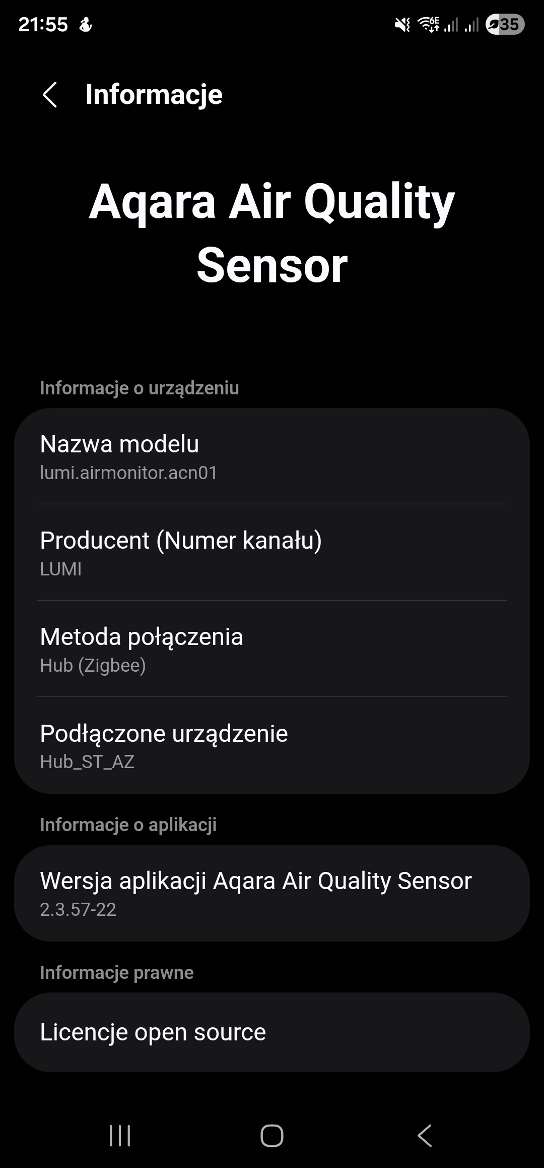

• Manufacturer: LUMI
• Model: lumi.airmonitor.acn01
• Hub: Hub_ST_AZ (SmartThings)
• Connection: Zigbee

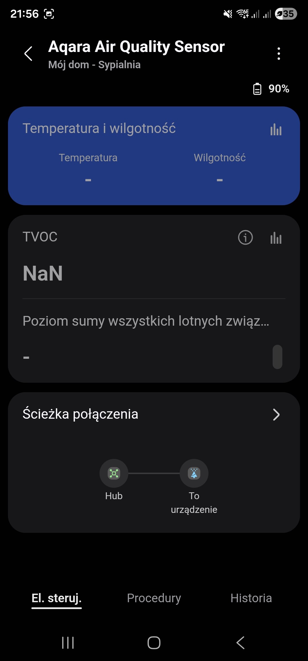

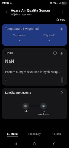

• Status: TVOC reporting works correctly, Temperature and Humidity missing.
Drivers tested:
:one: Temperature Humidity TVOC Sensor (iquix / Luluhappy channel)
→ TVOC works fine, but no Temperature or Humidity data.

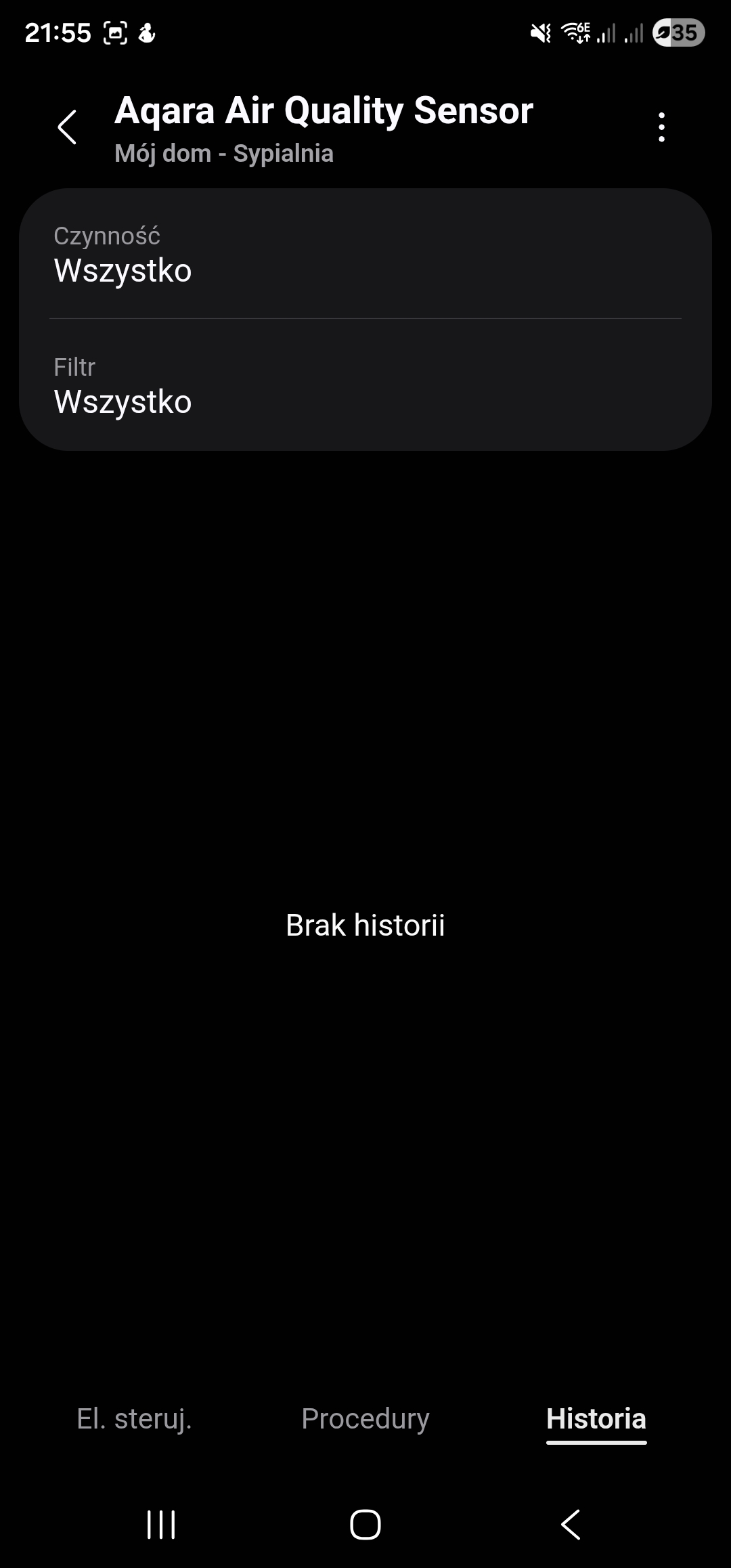

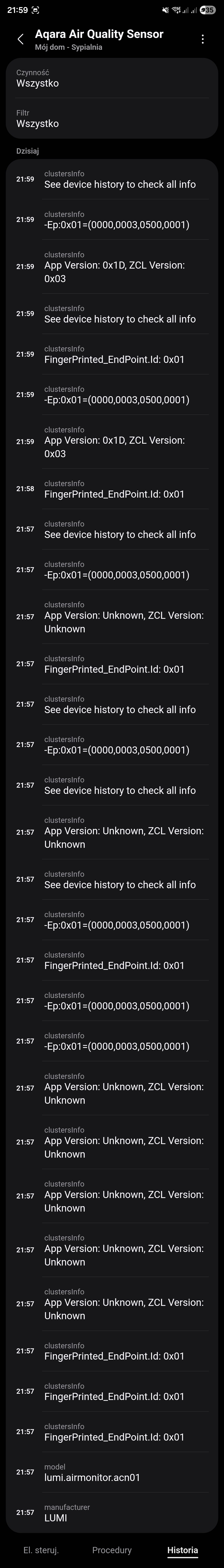

Observed data from History:
  • FingerPrinted_EndPoint.Id: 0x01
  • App Version: Unknown
  • ZCL Version: Unknown
  • clustersInfo: 0000, 0003, 0500, 0001, 0019, etc.
  • TVOC readings appear every few minutes.
  • Temperature and Humidity stay empty (“–” in UI).

I checked this driver and unfortunately it doesn’t work, it doesn’t show any information.
Please post some screenshots: from the device card, the driver information and information.
Have you deleted the device before installing the driver?
It seems that this device uses standard ZCL for temperature and humidity.
I’m not using this device now, but by the time that I made this driver, everything worked fine.
Maybe there could be some sort of firmware fragmentation, or there could be some sort of magic packet which needs to be sent.
something like this..
It takes quite a while (36 hrs or so) until the device starts reporting, and then only when the measured values change quite a bit.
It seems that
Temperature needs to change by 0.5°C
Humidity by 6% or so
TVOC by 0.030 to 0.035
So, @iquix ‘s driver still does its job :grinning_face:
For me, it’s like this with individual drivers. None of them work properly, even after a few days.
Please do not just switch the driver without deleting and adding the device back again.
Switching the driver in the app will cause issues! You really have to make sure that only one matching driver is installed at the same time.
Devices like this need to be configured properly, otherwise they won’t report data.
