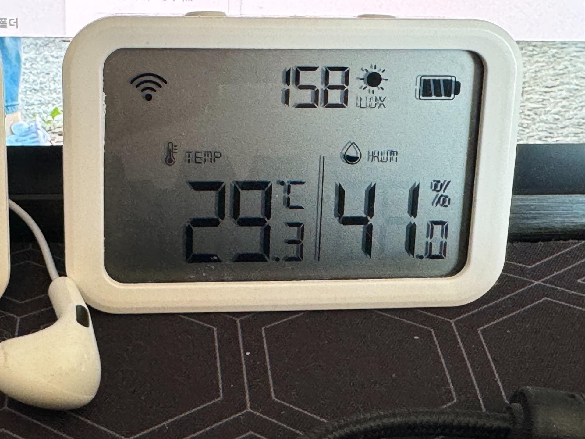

Hello
Thanks to Mariano, I’m using SmartThings well
Thanks a lot.
I leave a comment because I have a favor to ask.
Can you make a fingerprint of the temperature, humidity, and illumination sensors that I have?
I want to use it, but I can’t find the right edge driver
Thank you always.
Device Information:
Manufacturer: _TZ3000_qaaysllp
Model: TS0201
FingerPrinted_EndPoint.Id: 0x01
App Version: Unknown
ZCL Version: Unknown
Network ID: OxF867
Zigbee EUI: B4E3F9FFFE0C4E8D
Device ID: 7e5ee369-53cc-415b-
bb7b-e05e8f460ccb
Server Cluster:
Ep: 0×01={ 0000,0001,0400,E002 }
Client Clusters:
Ep: 0×01={ 0019,000A }
Signal Metrics:
