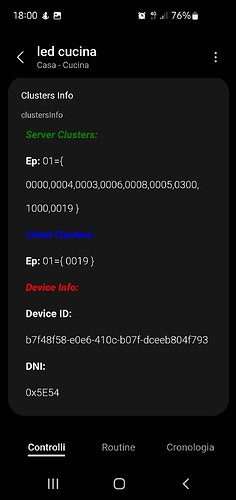

  • deviceId: β€œb7f48f58-e0e6-410c-b07f-dceeb804f793”,
  • deviceManufacturerCode: β€œ3A Smart Home DE”,
Hi @ivhazu
I need device model too
I confirm that the strip range is 2700k 3000k
Hi @ivhazu
This model exist in driver yet.
The problem is your strip temperature Color range.
You can choose in preferences the maximum color temp of 3000 k in preferences for the circadian function, for the rest of the functions I would have to modify the code or create anew option profile and new VIDs to adapt them to your strip, but it will take us a few days, I have a lot of work now
  • id: β€œ3A-Smart-Home/LS27LX1.7”
    deviceLabel: 3A Smart LXT56-LS27LX1.7
    manufacturer: 3A Smart Home DE
    model: LXT56-LS27LX1.7
    deviceProfileName: rgbw-level-colortemp-2700-6500
