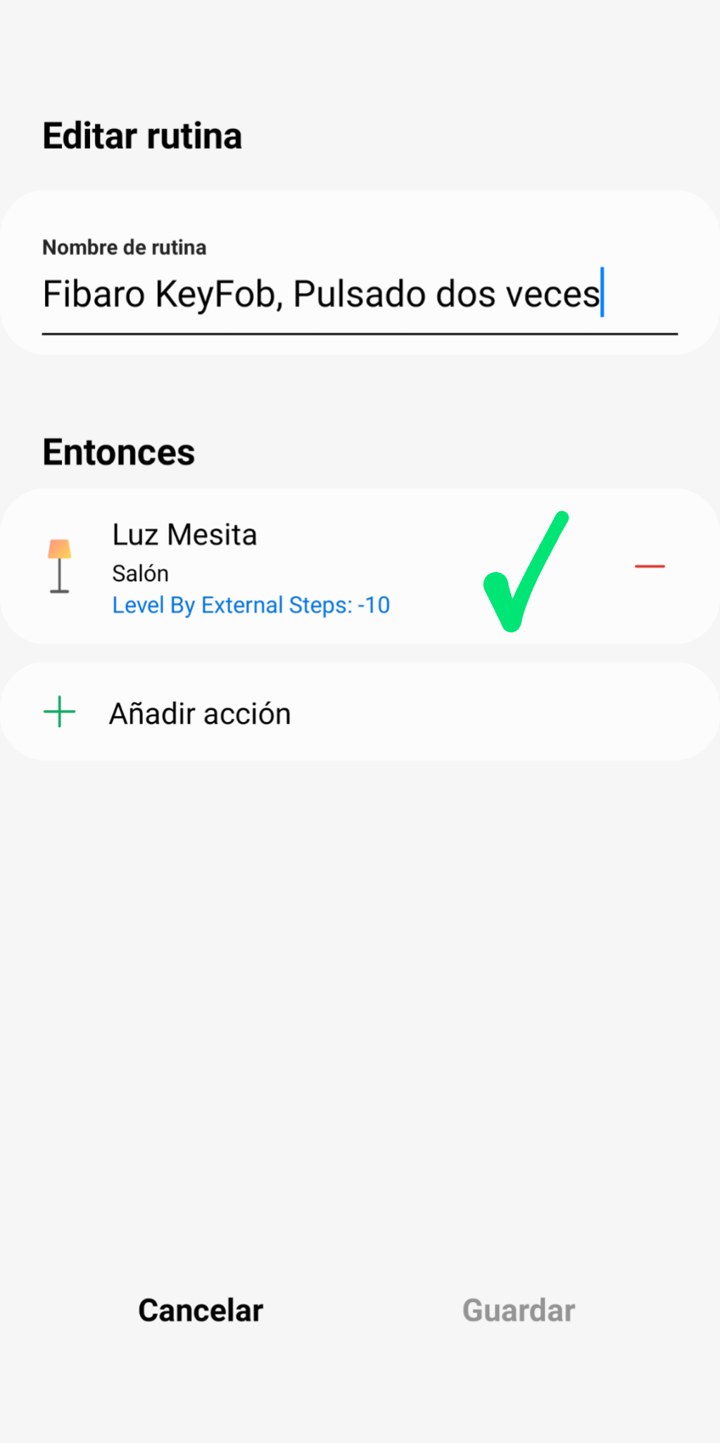

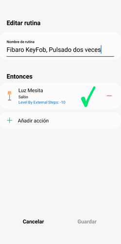

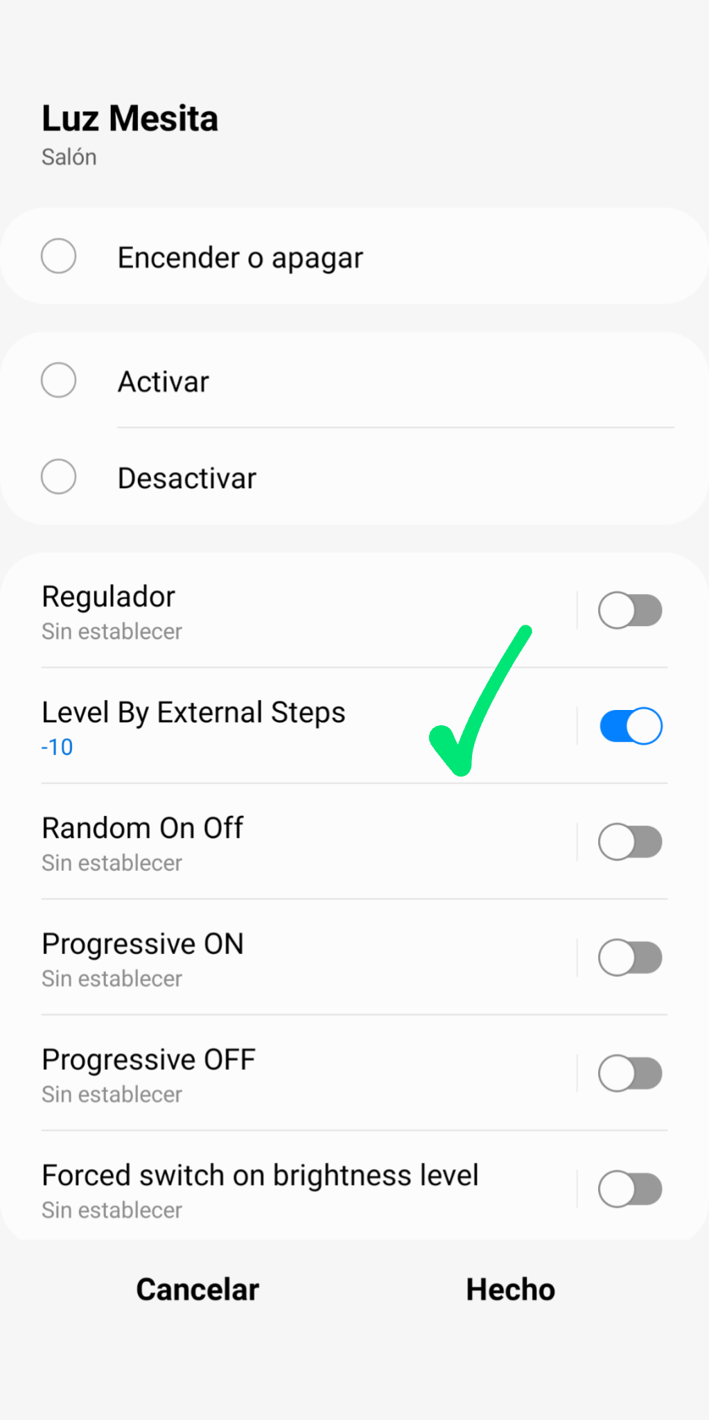

is it possible to set the operation of the IKEA buttons so that each time a button is pressed, the brightness of the bulbs is lowered or raised by, say, 5%, the next press by 5%, etc.?
The native operation of paired buttons and Ikea bulbs seems to work this way and is great.
In the settings, I only see the option to set a specific brightness value under a particular button, which is a bit pointless.
Hi @Marcin_K
If yours bulbs are paired with this driver then has the capability Level by External Steps.
You can create routines in the remote controller and assign pushes with % step to send it in action routine.
I have with a fibaro KeyFob to send steps 10% or -10% with two double pressed keys
