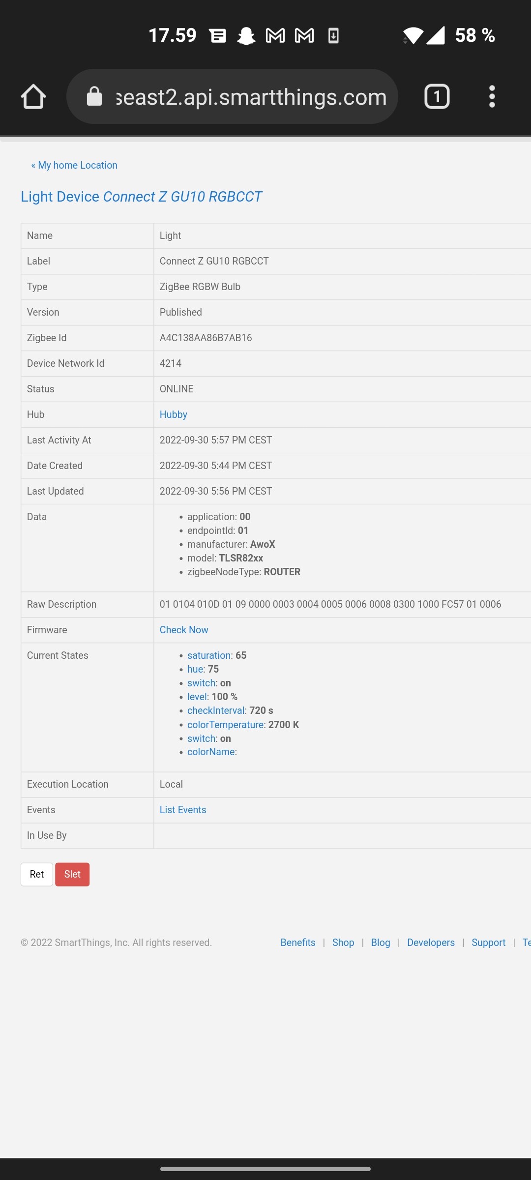

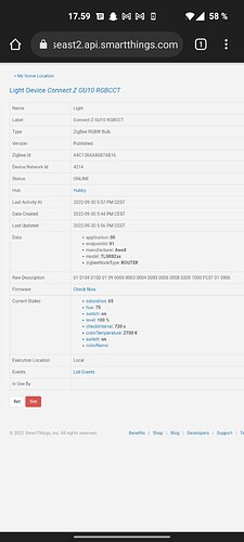

Found a new bulb not supported by any edge drivers.
Can you work your magic?
Added to this driver verson
 Name         Zigbee Light Multifunction Mc
 Version      2022-09-30T16:11:21.908554169
  - id: "Awox/TLSR82xx"
    deviceLabel: TLSR82xx RGBW
    manufacturer: Awox
    model: TLSR82xx
    deviceProfileName: rgbw-level-colortemp-2700-6500

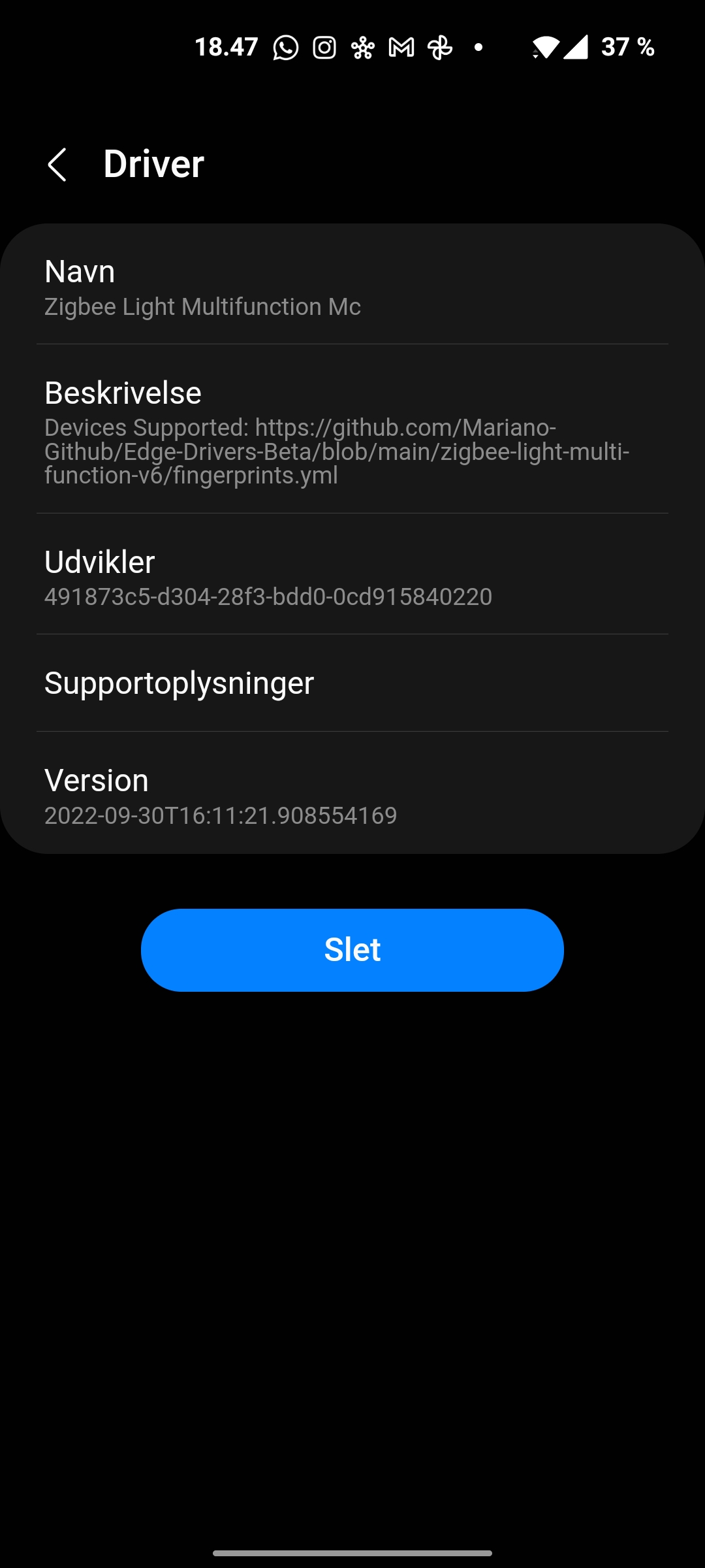

Hmm, it seems that the bulb won’t grab the edge driver. As far as I can see, I do have the most recent version of the driver installed on my hub.
Hi @Johan_Sundberg_Mulle
I had written AwoX with a small x
If instead of screenshoot you send me the text, I copy and paste and I’m wrong, but less :+1:
 Version      2022-10-02T17:06:49.239802529
  - id: "AwoX/TLSR82xx"
    manufacturer: AwoX
    model: TLSR82xx

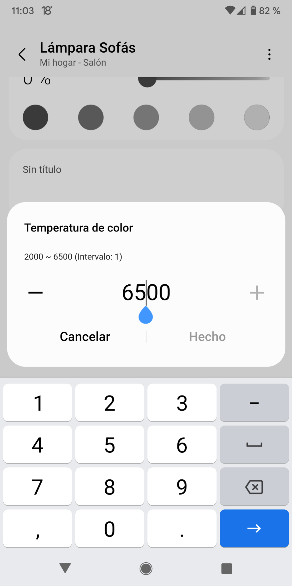

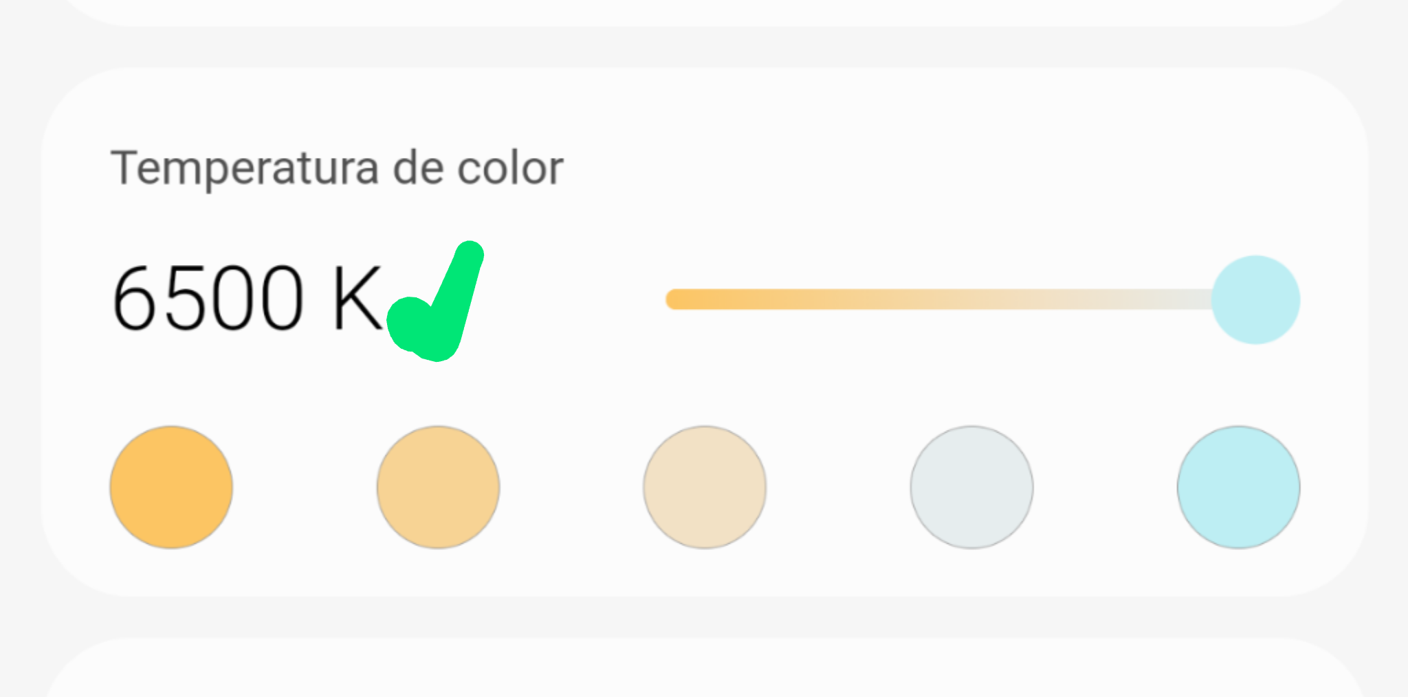

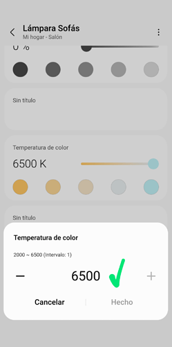

I wish there was a way to enter number for color temperature instead of using a slider.

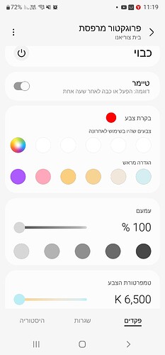

Hi @Mariano_Colmenarejo
I have a led reflector in my home with zigbee.
Right now its using DTH driver.
I am looking for edge driver
This is my projector
Tuya LED Smart Floodlight RGB Spotlight Zigbee Wifi Reflector Light Outdoor Waterproof Lighting 30W 50W 100W 220V
https://a.aliexpress.com/_EItMJQx
This is the reflector information from ide:
Data * application: 62
  • endpointId: 01
  • manufacturer: _TZ3210_leyz4rju
  • model: TS0505B
  • zigbeeNodeType: ROUTER
Raw Description
01 0104 010D 01 09 0003 0004 0005 0006 1000 0008 0300 EF00 0000 02 0019 000A
can you add this finger to your driver?
its can work together?
:pray::pray:
Hi @eric182
You can do that whenever you want.
Click on the color temperature value and the window will appear to enter the value you want. Click again in value and keyboard will appears or can clicking on + or -
Hi @Liran1115
Added to this driver version
Version 2022-10-06T09:09:47.869336544
  • id: β€œ_TZ3210_leyz4rju/TS0505B”
    deviceLabel: RGBW TS0505B
    model: TS0505B
Thanks thanks thanks!
working great!
